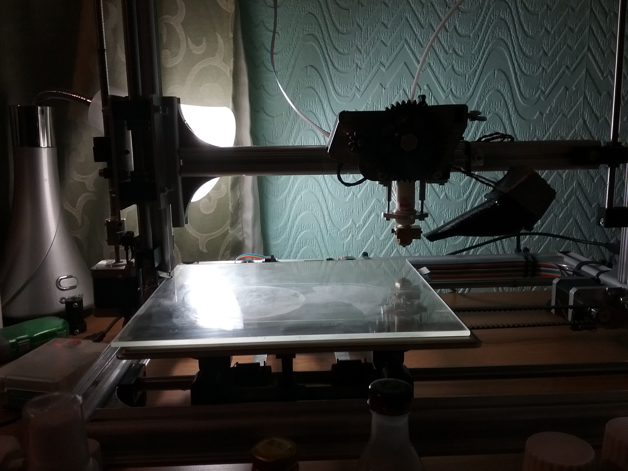

I've hit a strange problem with my 3D printer,
I’ve hit a strange problem with my 3D printer, basically what is happening is when it prints out a large surface area (approximately 5-8cm squared) the solid infill curls upwards and creates huge horrific ridges which the nozzle catches onto them.
The plastic i’m using is PLA from Excelvan and oddly enough that, from what i know, it needs constant cooling to prevent small overhangs from curling and my solution was to put the fan at max after the first 3 layers. Unfortunately this is the reason why the solid infill curls up and so far I have no idea why it’s causing the problem other than overcooling the plastic around it.
The photo below is my setup and it prints the 3DBenchy alright but it can but I can never manage to use the auto cooling in slic3r as it would not turn on during overhangs.
