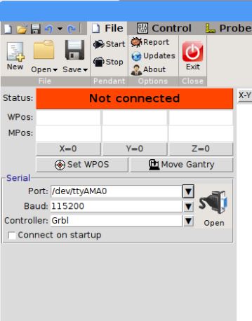

I've installed bCNC on RaspberyPI3 as follows:
I’ve installed bCNC on RaspberyPI3 as follows:
RP3 running Python 2.7.13
sudo apt-get update
sudo apt-get upgrade
sudo rpi-update
sudo apt-get install python-tk
sudo apt-get install python-serial
Downloaded bCNC from github
Extracted bCNC to my RP3 Desktop
cd bCNC
sudo python bCNC
bCNC opens, but I can’t connect with available ports.
Possablity I missed a package to install?
Maybe I need to manually type in a different port?
Attached are screenshots of what I’m seeing in bCNC
Baud: 115200
Controller: Grbl
Any thoughts?

Found the source of the problem - my E-Stop switch. Leaving it unplugged for now and bCNC shows “Connected”.
Guess its never easy - went to Control and tried to jog X-Y-Z independly, I get an “error:9”.
