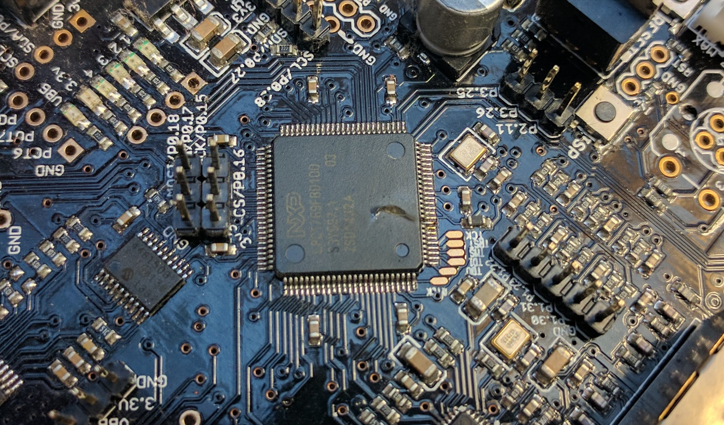

I’ve just fried my Smoothieboard when one of the cables (hotend temp) came loose during printing (it must have connected with GND or another cable).
What would people recommend replacing it with? I need to drive 5 steppers and LAN or Wifi (I currently use the Smoothie status page to monitor and control).
