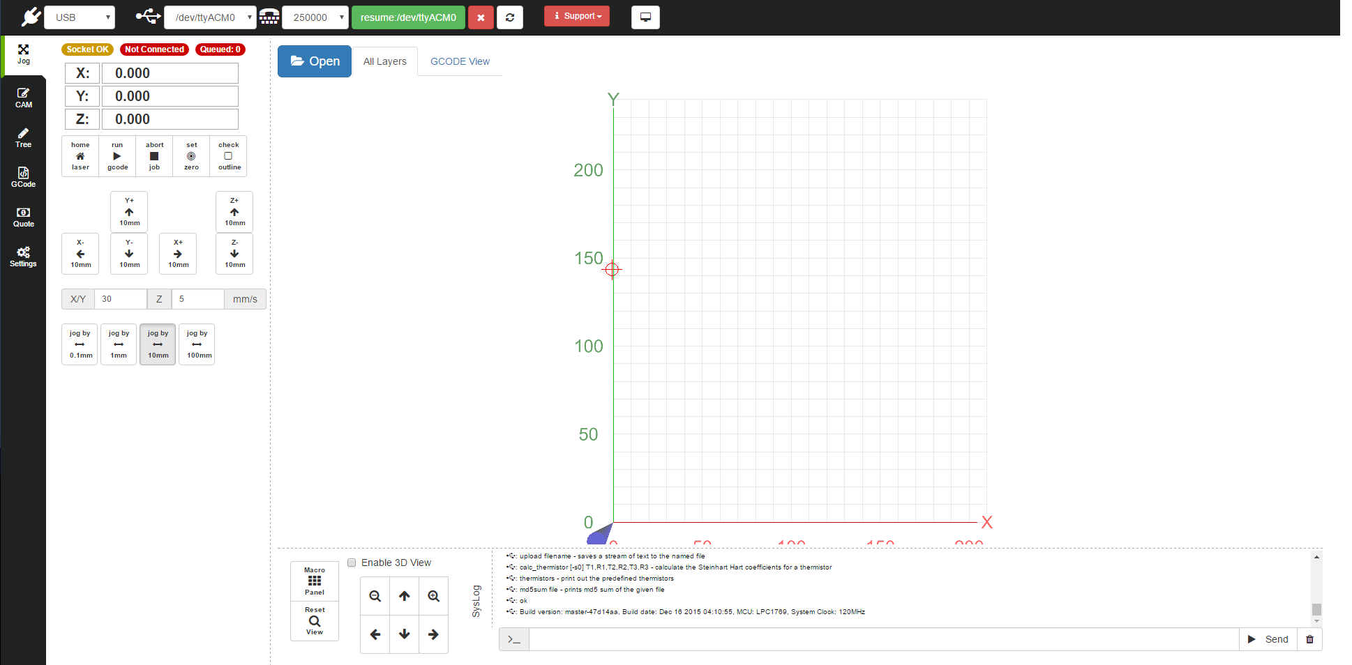

I’ve just installed LW3, I had previously LW.
The problem is that the USB connection is never made.

I think it does connect but something else its preventing it to work.
