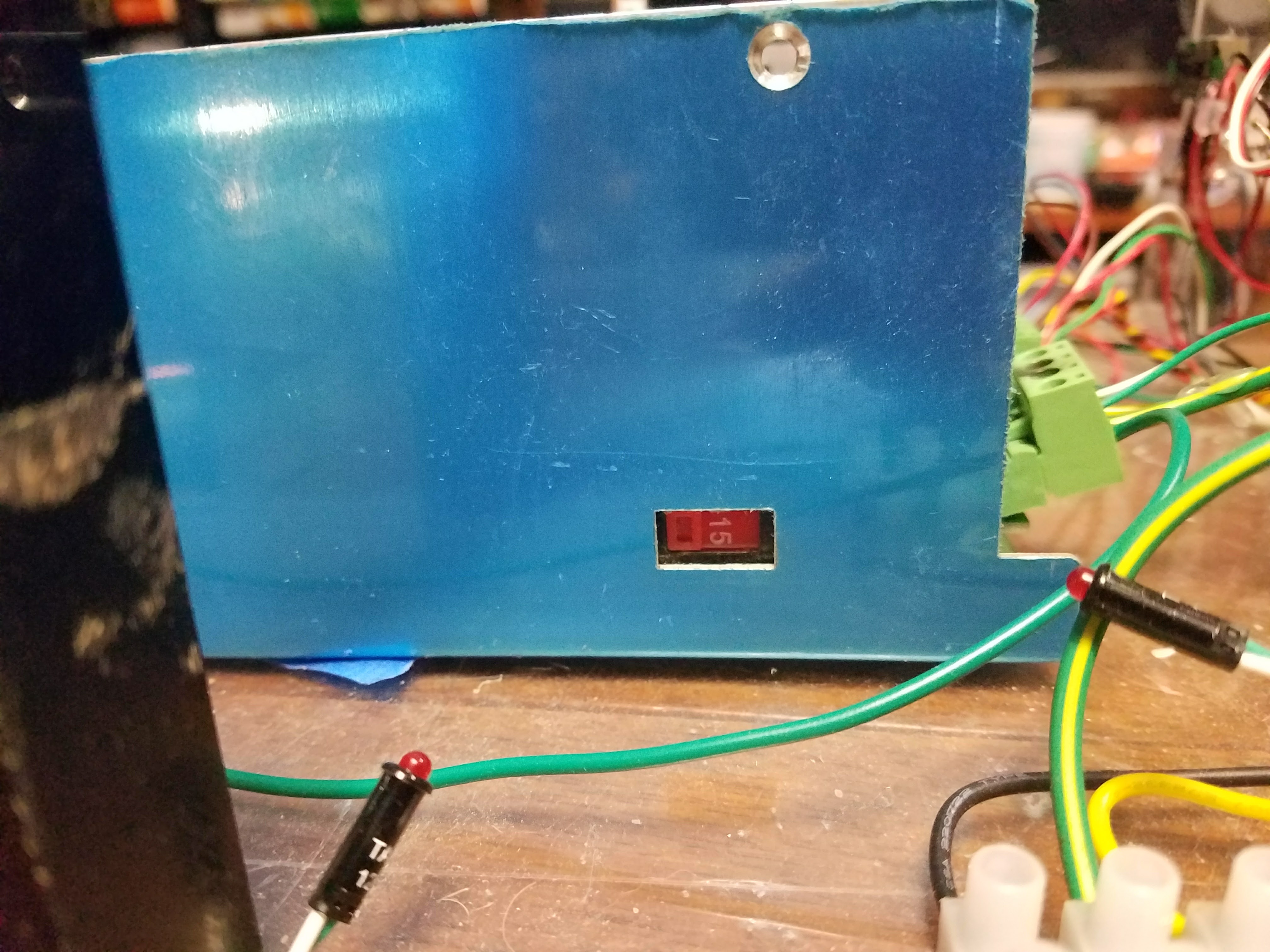

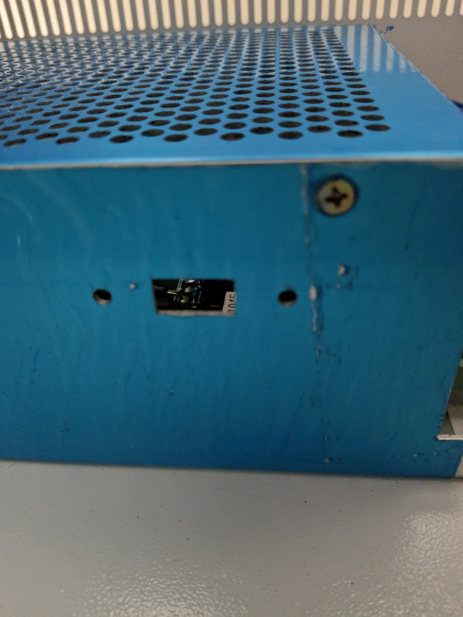

The switch is hidden behind the panel so you might need to unscrew the power supply switch it and remount. It is not a flip switch but an simple black slider. You will overlook it easily and take it for a label.
All K40 LPS that I have seen have this switch

@Dushyant_Ahuja it’s just a black slider with 110/240 engraved. Hard too see since it’s all black maybe @donkjr has some photos of it.

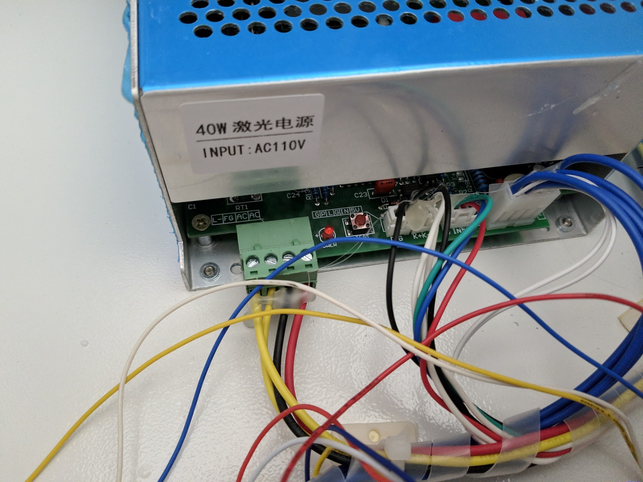

On left hand side of supply. Post pictures of your supply please showing connectors and this side.

The switch is missing.
