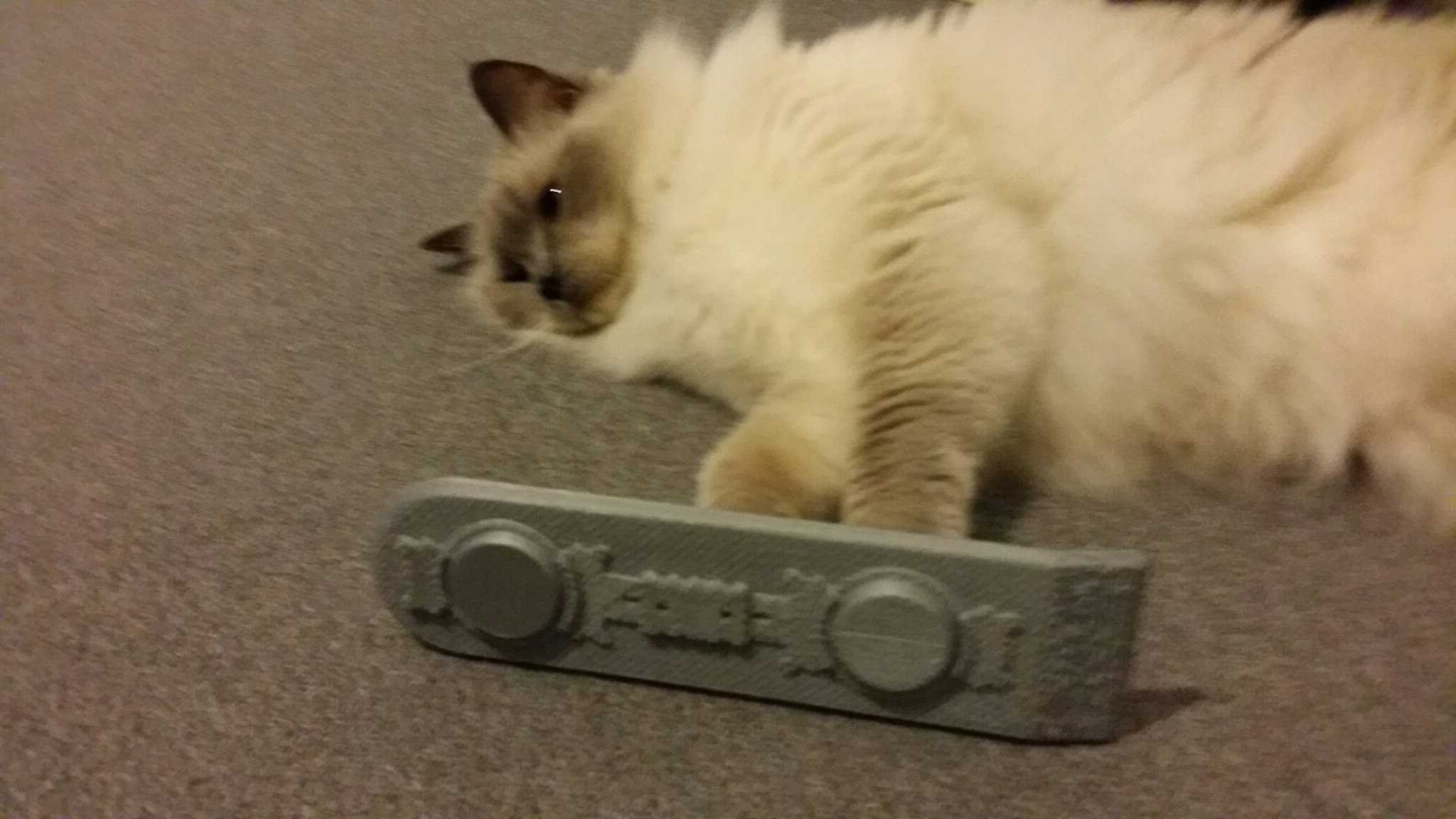

I’ve learned a valuable lesson. While I’m still trying to absorb all the tips you guys gave me in the last few days I decided to try printing something fun, a hoverboard. After a disappointing initial outcome, painful clean-up and messy result (all pictured) I stumble across a stupidly simple idea. Eliminate the need for support structure! Break up the hoverboard into 4 parts (3 levels) and print separately. Super glue each level (1 board, 1 base, 2 disks) and voilà! Super-clean results. Didn’t take any photos, but it’s very neat. I found that if I set software to print one object at the time gives better results instead of jumping between objects which tends to cause warping… I’m guessing due to cooling.

Is cat 3D printed too? His fur couldn’t look any more fake.

@Kenneth_Sloan hahaha that’s exactly what I said to one of my colleagues while cleaning it up. “I could have %$^^& carved it out by hand by now.”
