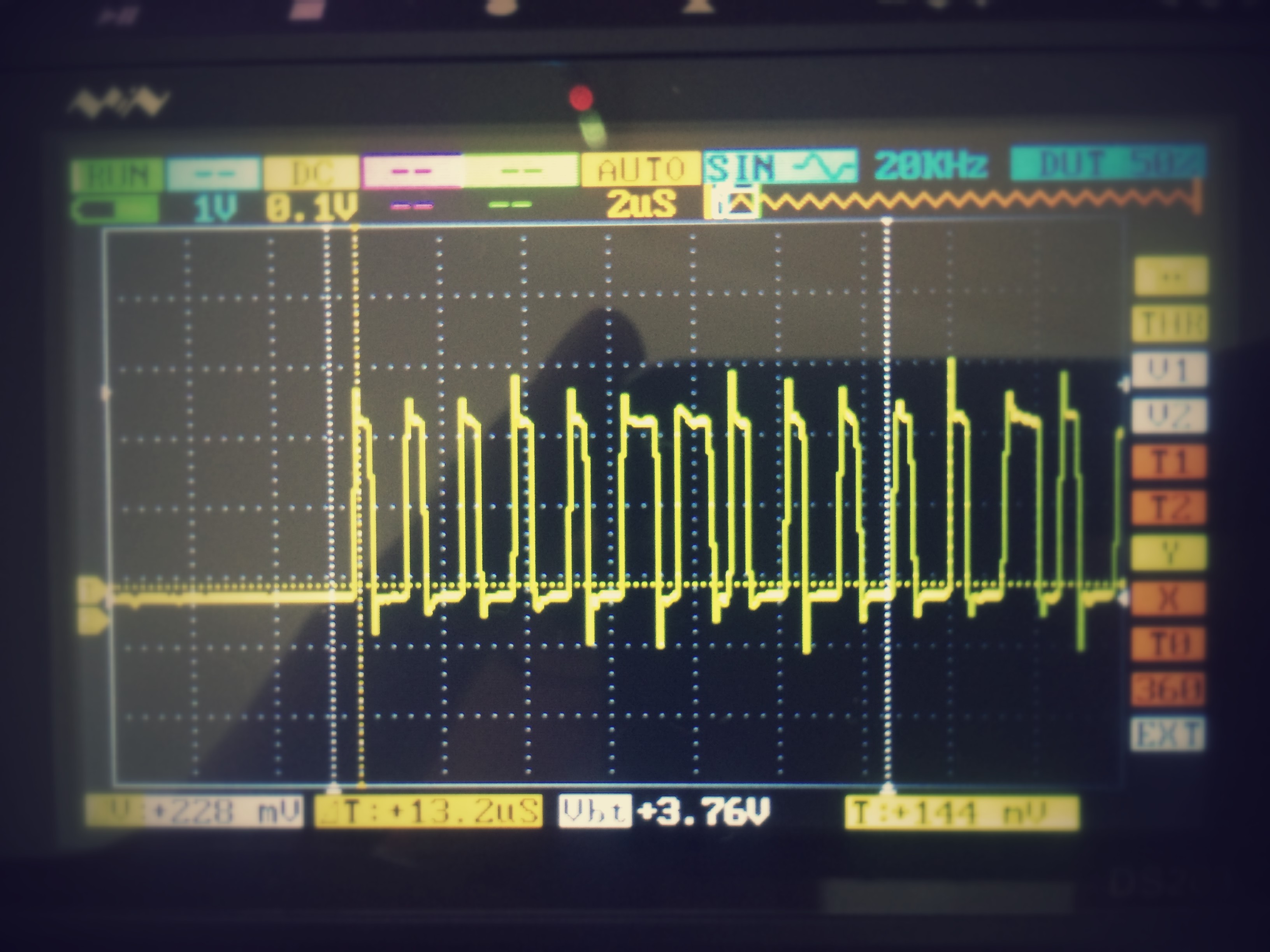

I've never owned a scope before and bought one on a whim — it
I’ve never owned a scope before and bought one on a whim — it turns out to be hideously difficult to use.
What else to test it out on but some WS2812—
After five minutes of fiddling I got something that looks remotely like I expect it should.
Hi, I bough the same one. You’ll get better results, when you use the digital inputs of the DSO (the green & pink one).
Ahh yeah— that’s much better! The picture now relates to the datasheet!

Catching digital signals on a scope is always trial and error if it doesn’t have built in decoding. Usually with my Hantek dso5102b I just set it for single shot capture where it just grabs one buffer worth of data and stops. You can then scroll around and zoom in as you need. It is a balance between waveform resolution and length of recording, too far out and you record a longer sequence but you lose detail in shape and transients when you zoom in. If you are too far in you get great detail but a small length of sample time.
@Daniel_Garcia I’m pretty sure this thing is a piece of junk compared to a proper oscilloscope — it goes by the model “DS203” — tiny handheld thing.
It’s good enough for me to see that stuff is happening etc — I wouldn’t trust it for measuring anything.
In digital mode I was quite thrilled to be able to see and measure the WS2812 data and see it matching the datasheet. As mentioned above — probably quite trivial.
Well that may be but like you say it’s good enough for you to see what’s happening, that’s the important thing. One of the most helpful things in troubleshooting is being able to visualize what’s going on.
@michael_hillpot t totally— I just mean in comparison— it’s actually just cryptically difficult to use
