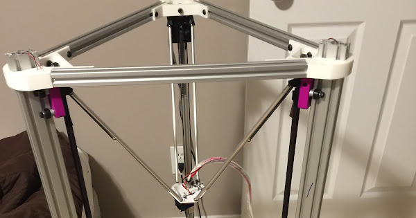

I’ve attached a gallery of all the printers I’ve built/upgraded. Currently I’m finishing the large delta that is in the album. A few print quality issues and calibration issues left to sort out. I’m also still in progress on a printed case Tantillus (it’s a very challenging build).
