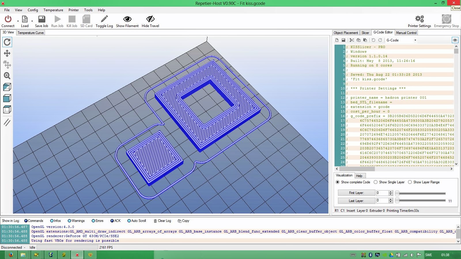

Last night I sat down and tried out #Kisslicer and I am actually laughing here. I’ve just finished my very first Kisslicer print and with pretty much default values straight through except for the printer specifics and the parts interlock perfectly! haha! Very impressed!
The scale of the parts are a tiny bit off but but that’s a minor detail since the error is overall. Should be easy to fix by tuning the settings. They FIT!
Check out this very non-scientific but pretty interesting comparison of the GCode visualization;

@Jim_Peterson I am just jusing Repetier Host for GCode visualization. Among all the GCode viewers I use I think it gives me the best representation of the end result. I run all tools individually. Mostly designing in OpenSCAD. Slicing in Kisslicer/Slic3r. Printing with Octoprint on Raspberry Pi.
