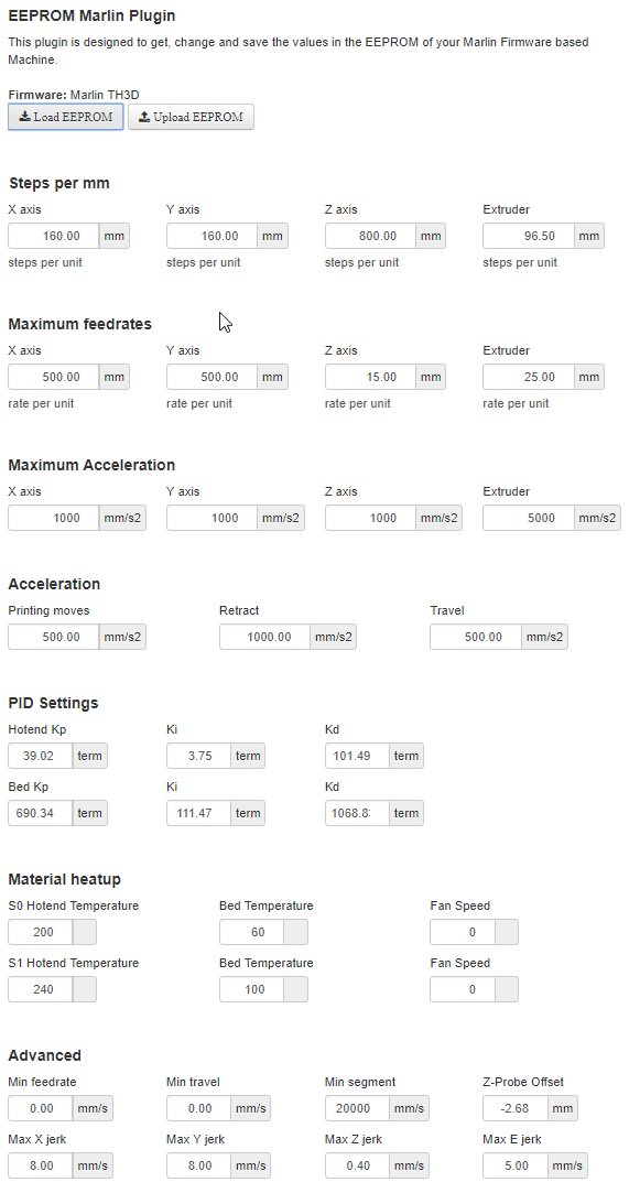

I’ve recently decided to go to ramps on my creality cr-10, and I’m running a dummy proof version of marlin 1.1.8. However, I just purchased a RAMPs 1.4 SB premium board and a re-arm. I’ve never used smoothieware and not sure how to start and what marlin settings translate to smoothie. I’m just using a capacitive probe, drv8825’s, nothing else really special. I know my esteps for extruder, and the X/Y/Z 160/160/400 here is my eeprom settings if anyone can help. My build volume is 300/300/400 also my probe offsets are
#define X_PROBE_OFFSET_FROM_EXTRUDER 63
#define Y_PROBE_OFFSET_FROM_EXTRUDER 0

@Dushyant_Ahuja The reason I ask is that since there is no offsets in smoothie like there is in marlin I don’t see how you can tune the probe x.xxmm from bed and then set a negative offset to z when it decides to print.

@Dushyant_Ahuja Ok, so it seems I just leave it as an endstop and when probing set the offset from trigger using G30 Znnn so for me as example would be G30 Z-2.68. From there create a mesh and save it and instead of adding G29 or whatever in start script just do G28 then G30 Z-2.68 and call it a day?
