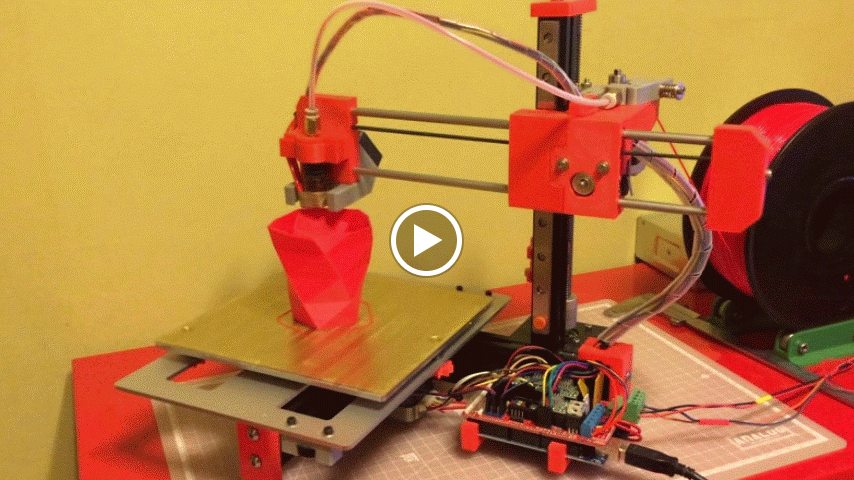

I've tested ABS printing with PEI build platform.
I’ve tested ABS printing with PEI build platform.
Build bed consist of 0.03" PEI sheet + Al plate + PCB heater + cork sheet.
I really like PEI sheet. No more worrying about lifting issue.
It is definitely much better than kapton tape and ABS juice or hair spay.
And bottom layer finish looks better too.
What model of printer is this, I rather like the simple design!
@Bruce_Lunde Thanks, I designed it and call it Rpstik :slight_smile:
How the PEI sheet is attached to aluminum, and where did you get it? I’m very interested of using this on my build.
Your printer looks good!
@DongWon_Han_DWONH I am most impressed then! I thought it might have been just a reprap model you customized! Are your design files available to others?
@Topias_Korpi I used double sided tape.
You can buy it from http://www.amazon.com/gp/product/B007Y7CYL0/ref=oh_aui_detailpage_o00_s00?ie=UTF8&psc=1
Thanks!
