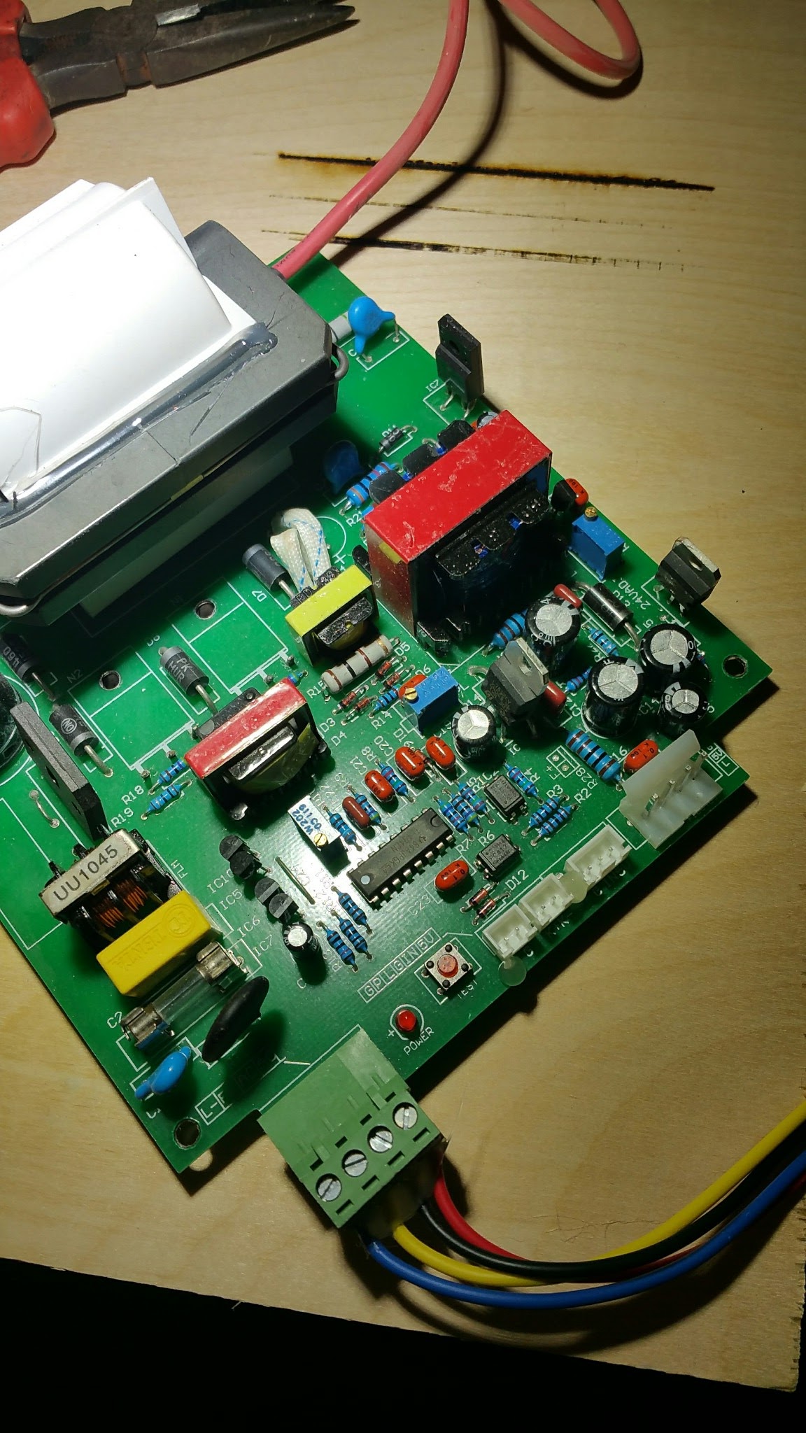

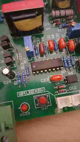

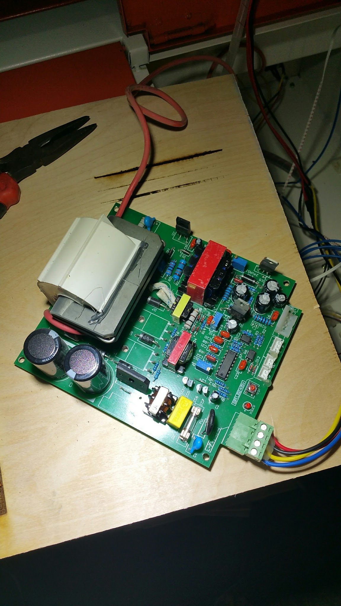

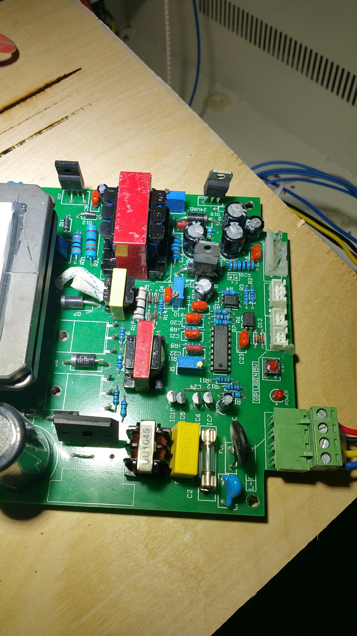

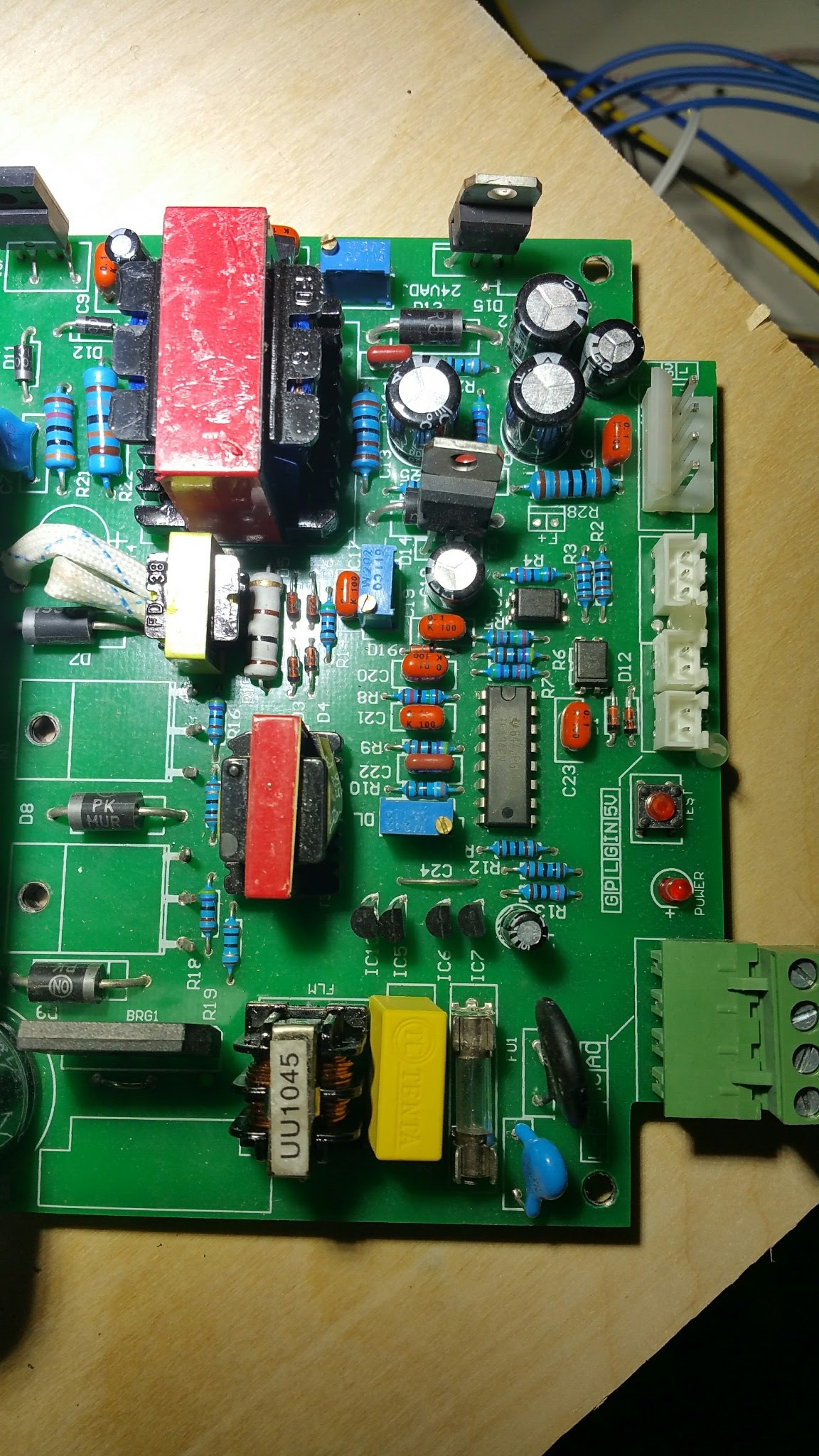

@tyler_hallberg pls post close up pictures of your LPS. Show the edge connectors and also show the board where you removed/replaced the diode.
Pictures of the power transistors might be helpful as well.

Sorry did not short out the L but did give it power as that’s how I had it running at one point with my Smoothie. I’ll post pics shortly
@tyler_hallberg note: the L needs to be grounded to fire. Assuming the interlock circuit is closed.
I hooked it up multiple different ways on the Smoothie board as well as swapped in the old circuits to see if I could get it working. Nothing made it fire. I’ll post pics in a couple minutes of the board

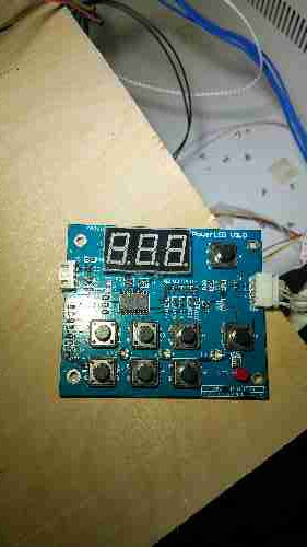

Test switch that does work
Stock board that has the test switch that does not work
@tyler_hallberg ah this is not a standard K40? Any schematics for that control panel board?
It’s the new “upgraded” version
