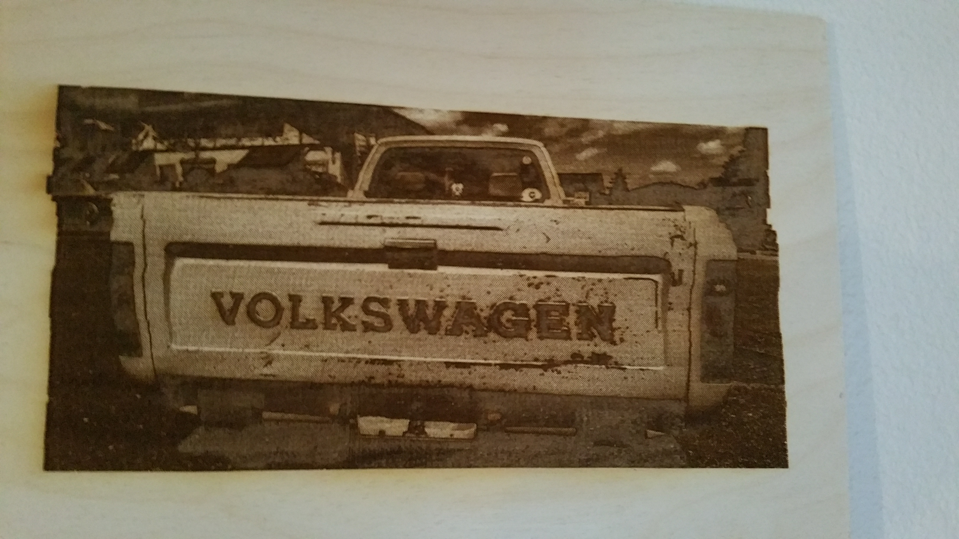

I’ve tried multiple pictures, and all seem to be doing it. At random spots the laser will jump a few cm for about half an inch then get back on track, so there is a section of the picture that is shifted over. Some do it at the top, some at the bottom, some in the middle. Any ideas?
If it’s any help I’m using a k40 running Smoothie. I have not tried running the code in lw4 yet to see if that helps, figured Id jump on here to see if anyone has run into the problem
Those look to be shifts. Have I already had you turn the potentiometers on the drivers up a little bit?

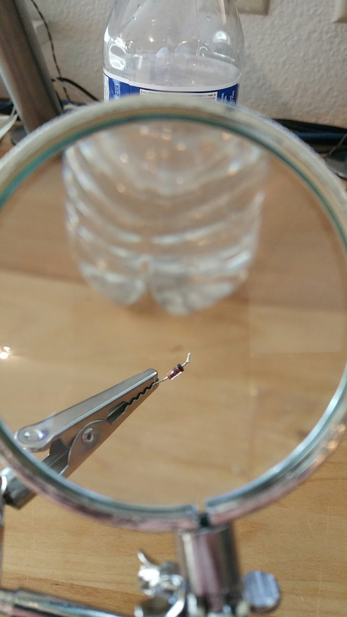

I think that’s a diode not a fuse. Can you read what’s written on it?
It’s hooked up how @raykholo sent in the directions. It’s also getting power from the USB cord
Been trying, can’t make it out, may have to take a trip to frys to see if I can find something
Take a picture of where it came off the board… @donkjr might be able to tell you what it is if he knows where it came off the psu
scratch that, diode is good, back to testing things on the PSU
@tyler_hallberg was about to say that that looks like a 914 signal diode and probably not your problem.
