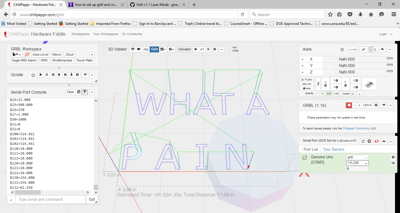

I’ve tried reading some other instances of folks receiving Not a Number(NAN) in their GRBL workspace. I’ve tried re-flashing the version of Grbl (1.1) as well as trying in multiple browers. When I change the port server to “default” I don’t get NaN but I also do not get any coordinate tracking. I’ve tried turning on and off the filter as well and do not have any success. I would appreciate any help on how to get my coordinates to work, or what I did wrong in the setup to fix it.

Grbl just stopped sending both MCO and WCO at the same time, because that’s redundant and slows down communication. You can select with $10, what coordinate system info to send and have to calculate the other one in CP.

The status report parser must be corrected for the new response format (around line 341).

to allow compatibility with 1.1 parallel code would need to be written to process output depending on the version number.
not only position information has changed. also G28/30 behaviour has changed and alarm reporting likewise.

I saw another thread suggesting $10 is a way to fix this. Better grbl 1.1 support would be appreciated, of course.
