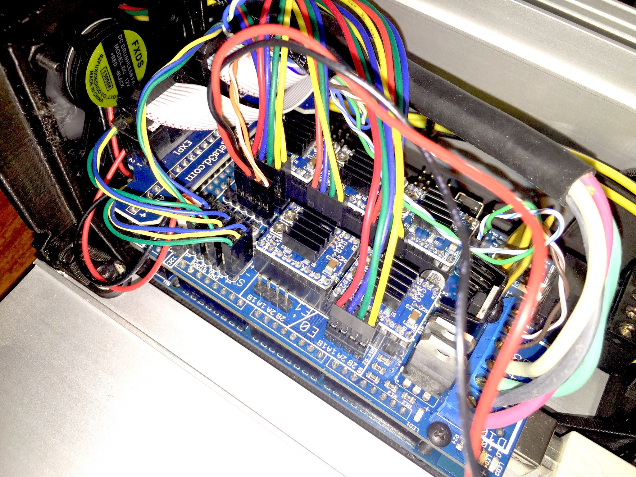

I've tried to find this answer on various forums and the reprap wiki but
I’ve tried to find this answer on various forums and the reprap wiki but I haven’t been successful. I’m in the process of adding a heated bed to my gmax printer but I’m confused as to what modifications I need to make in Marlin to utilize the heated bed. I don’t know what pins to assign to the thermistor in pins.h and I don’t know how to assign D9 to power the heated bed. I know in configuration.h there is “#define TEMP_SENSOR_BED” and I can set that to 1 but I don’t understand which pins on the physical board that corresponds with. I wish there was a full tutorial I could watch on how to set this up.
Looks like RAMPS 1.4 see this image and page on reprap wiki.
http://reprap.org/wiki/File:Rampswire14.svg
D8 is your output for heated bed
On the Gmax they use D8 to power the fan that cools the prints. I want to use D9 for my heated bed as that is what is currently open on my board. I looked at that diagram but that doesn’t list the pin numbers, I’ve been unable to find a complete list of pins for the ramps 1.4 board anywhere.
See… https://github.com/ErikZalm/Marlin/blob/Stable/Marlin/pins.h
Different board have defined different pins
D8 and D9 are the outputs of microprocessor.
See line 720 of pins.h
I think you want your heated bed on D8 since that is the output connected to the transistor with that big ass heat sink. Of all the items in your printer, the heated bed will draw the most current and cause the transistor to generate the most heat.
I would recommend changing your board in marlin to the RAMPS EFB (Extruder Fan Bed) configuration and changing the board wiring appropriately.
That makes sense I knew D8 was the high powered output but I wasn’t worried about current draw since I am using a relay with a separate power supply.
You can power on the fan with the 12v ramps input. In orther to have d8 free.
In marlin make shure you have selected the 33 for board in the upper section (ramps 1.3/1.4 extruder, fan layer, heated bed). And choose the termistor. And that’s it
Alright I figured it out, all I had to do was watch Thomas Sandladerer’s firmware videos and it made sense how to make the necessary changes in Marlin to get the heated bed and thermistor to work.
