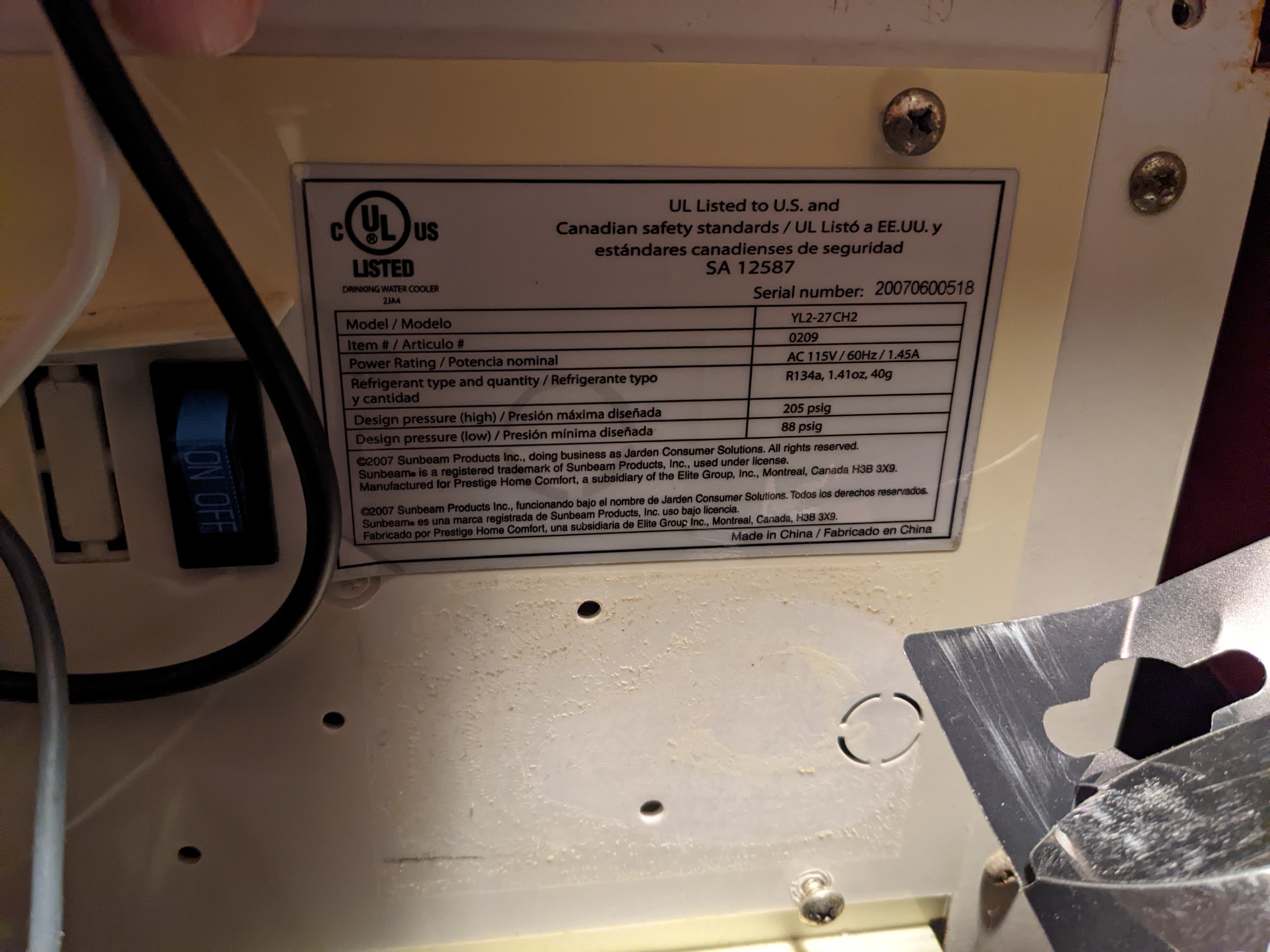

My chiller setup is an office type water cooler (the kind with the big jug on top). I didn’t really modify the cooler, I just put a coil of copper into it’s tank. The cooler keeps 1 gallon of water at 33 degrees, when my 3 gal of laser water gets too warm it kicks a pump on through the copper coil. I’d have to check the specs on the cooler, I think I gradually heat up the water, but I never run for long enough to get it too warm.
I assume this is deg F? :smile:
:laughing: Yeah, honestly it’s probably at 32. It will form a little ice… takes a long time to heat up from there though.
I have a similar configuration except I just dropped a aquarium pump into the cooler reservoir and bring the chilled water in HomeDepot flexible hose to 1/4" coil of refrigerator water line(already coiled) placed in my 5 gallon laser water reservoir. I put insulation over the cold line going to the 5 gal tank.
Works ok if I have the chiller pre-cooled( ~6 hours ahead ) and I don’t run it for more than a couple hours. I’ve added a fan to the chiller heat fins which might help speed up chilling and chilling capacity but the reservoir is only ~1/2 gal.
The Jaegermeister chiller seems to get close to freezing so it probably has better capacity than my water chiller setup.
