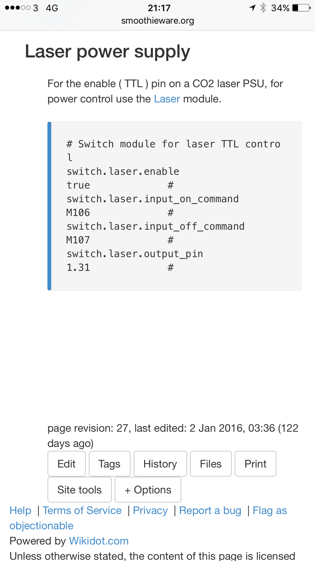

Jean-Baptiste Passant ,You mean switch like this?
@Jean-Baptiste_Passa1 ,You mean switch like this?
Exactly :wink:
Just change the m106&M107 to G1&G0
So laser on during linear feed and laser off on rapid? So there is no circular interpolation movements when generating your gcode?

:frowning: in my board version pin 1.31 is used by glcd,can i change this for any other what is free?
I dont want lose my display
Yes, just see on the smoothieboard website, you can use other pins, I used 1.31 because my LCD was not working but you have a few options possible.
