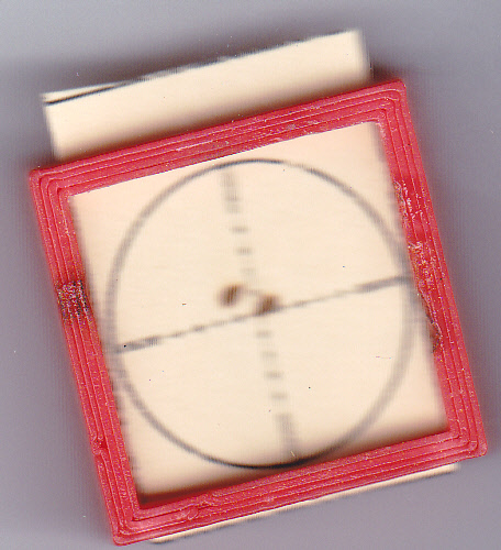

This is what i am getting for a target this is @3-4 MA sorry for the blurr so i saw this and swaped out all the mirrors to see if that made difference and it did not, right out of the tube to the fixed mirror it was just one dot but from that mirror to the next this is what i get.

Looks like it’s not hitting the center of the 1st mirror…I’ve had that happen to me when I installed the new tube in my machine.
Or it could be similar to the issue I am having currently. First mirror hits dead on centre, but from there the 2nd mirror hits at 2 different spots when at the front & back of the rail. Mine is less severe, but it is related to the beam coming off the 1st mirror not parallel to the rail (or 2nd mirror in both front & back position). I originally had this issue when I first got my K40 & solved it by levelling the 1st mirror (by putting some washers under it before screwing it’s housing down). It seems that some screws at the back of the 1st mirror mount are touching the U-shaped mount below it, that forces it to angle downwards (on mine).
well it is little off the center not by much how could that cause it to have a split beam from the first fixed mirror to the y mirror.

@Dennis_Fuente I didn’t register that was from the one firing. I thought it was from firing at 2 different positions. So my previous response isn’t related to the beam splitting. I am unsure as to why the beam splits, but I just had the same thing happening with mine over the last couple of days (with the beam splitting). I don’t know what caused it, but after realigning my mirrors it has stopped splitting the beam in 2. Mine was splitting after the 3rd mirror, just before the lens. I have a feeling it was related to the mirror/lens head being slightly rotated & the beam was hitting the 3rd mirror high, instead of the centre. After cleaning mirrors & lens & fixing the alignment so it hit centre, it seems to have no splitting now.
