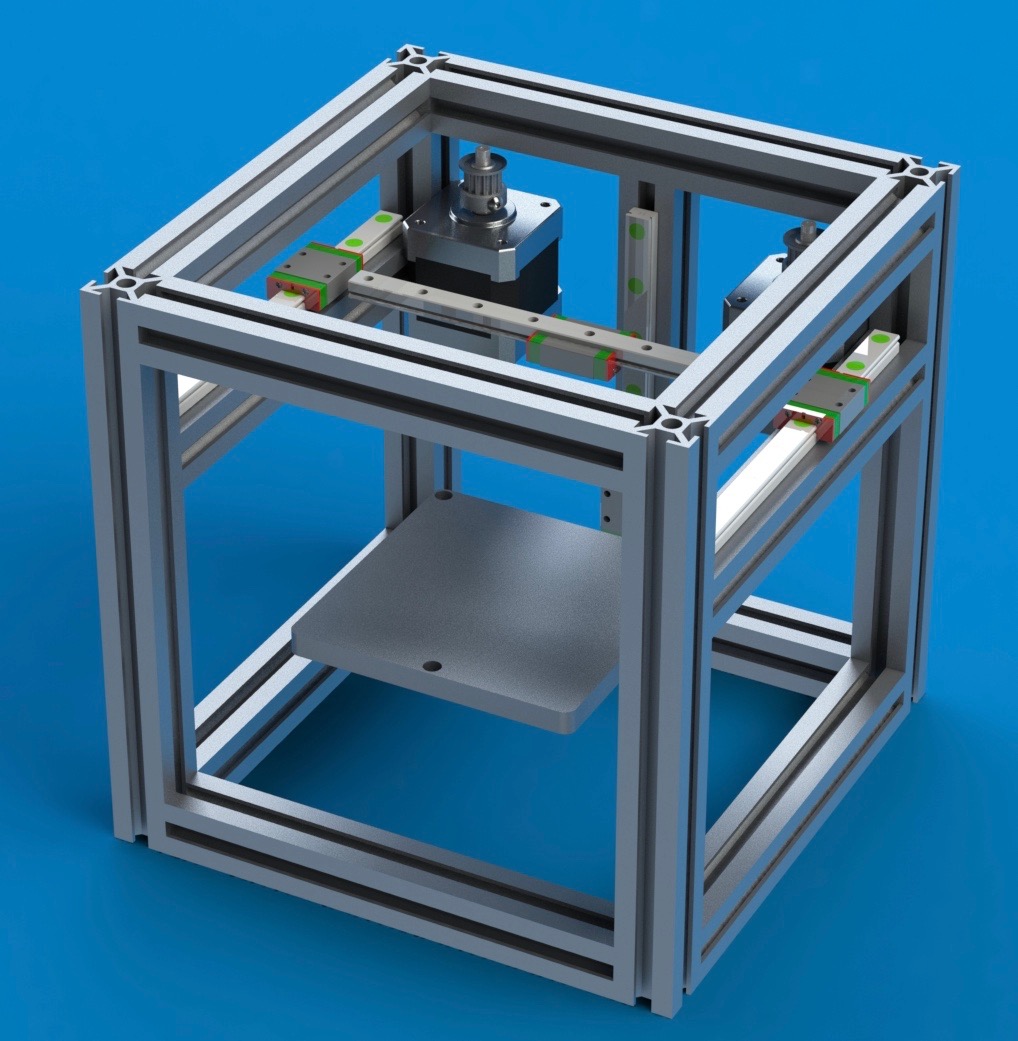

I think the pictured frame can still work better with some changes. You’ll need to place the spool somewhere anyway, moving the motors behind the frame shouldn’t make the machine’s operational volume any bigger if the spool is on the rear face. Cut a belt passage slot through the rear vertical extrusions and you can move the motors outside the frame and closer to the corners. That should get you 40 mm more X travel.
nah, more like 13mm more Y and no X. I tried it all
And putting the motors on the outside is ugly as fuck
I agree, it is tempting to simply move every thing outside the frame, hence increasing the build volume. But, in my opinion it is like building a house and putting all the appliances on the exterior of the home. Ugly.
My question to that is where are you putting the spool? If you’re going for pretty, you’re going to want a housing anyway, and you can house the motor and spool on the back of the frame.
Hey, @Jeff_DeMaagd , I upped this pic because of @Johan_Jakobsson did mention something about building a small printer with extrusions. This is just a digitally CAD-design to show that I already thought about this and it would not work.
