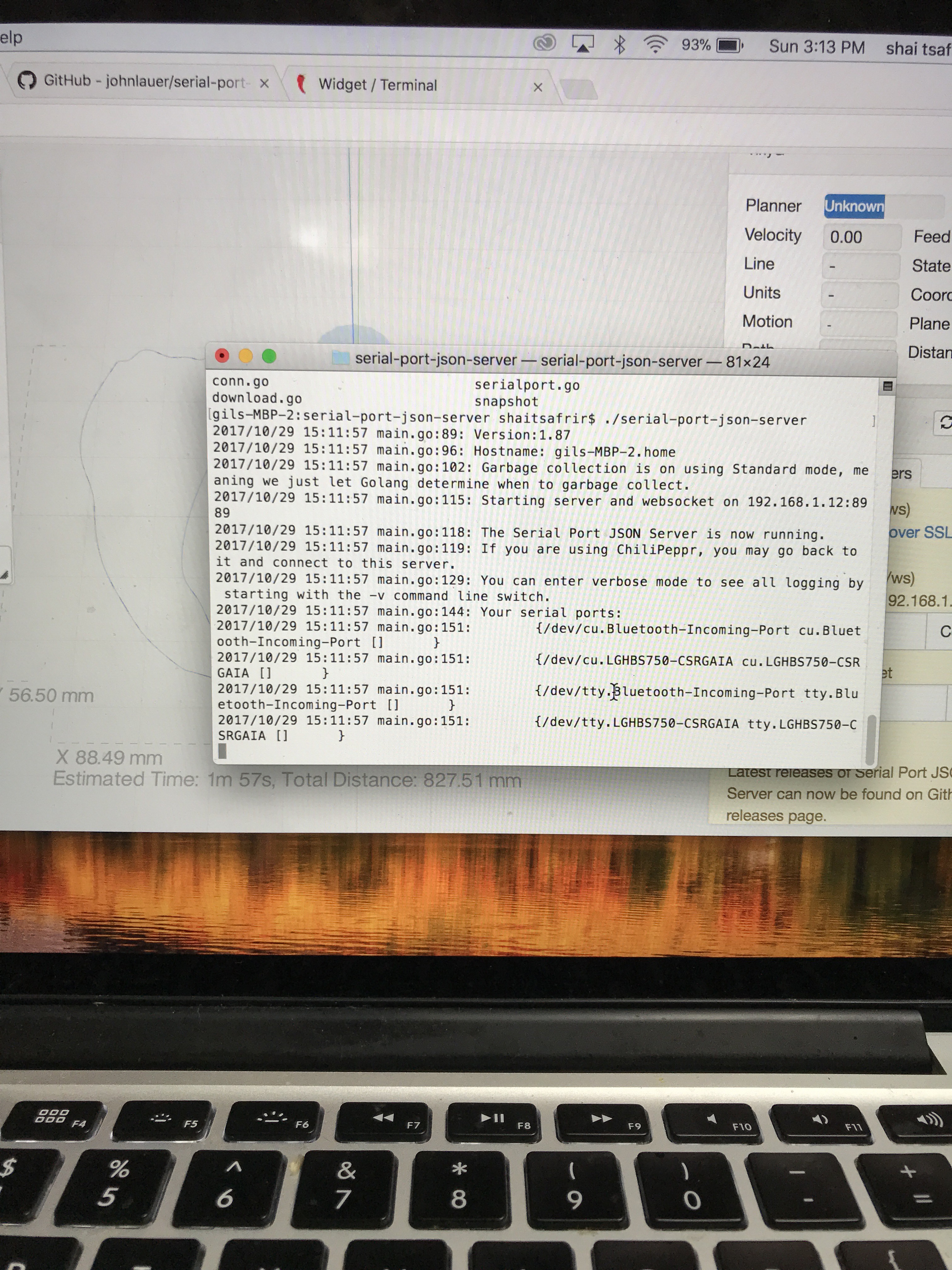

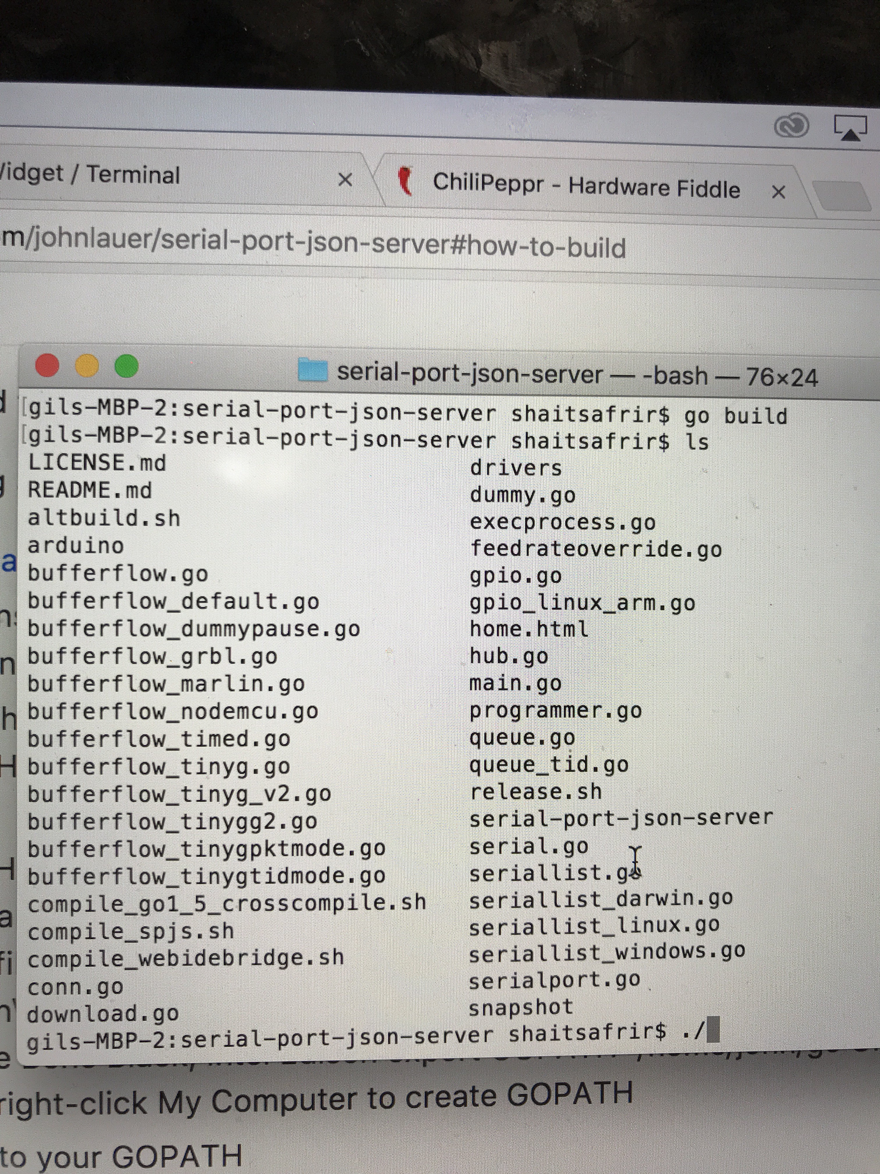

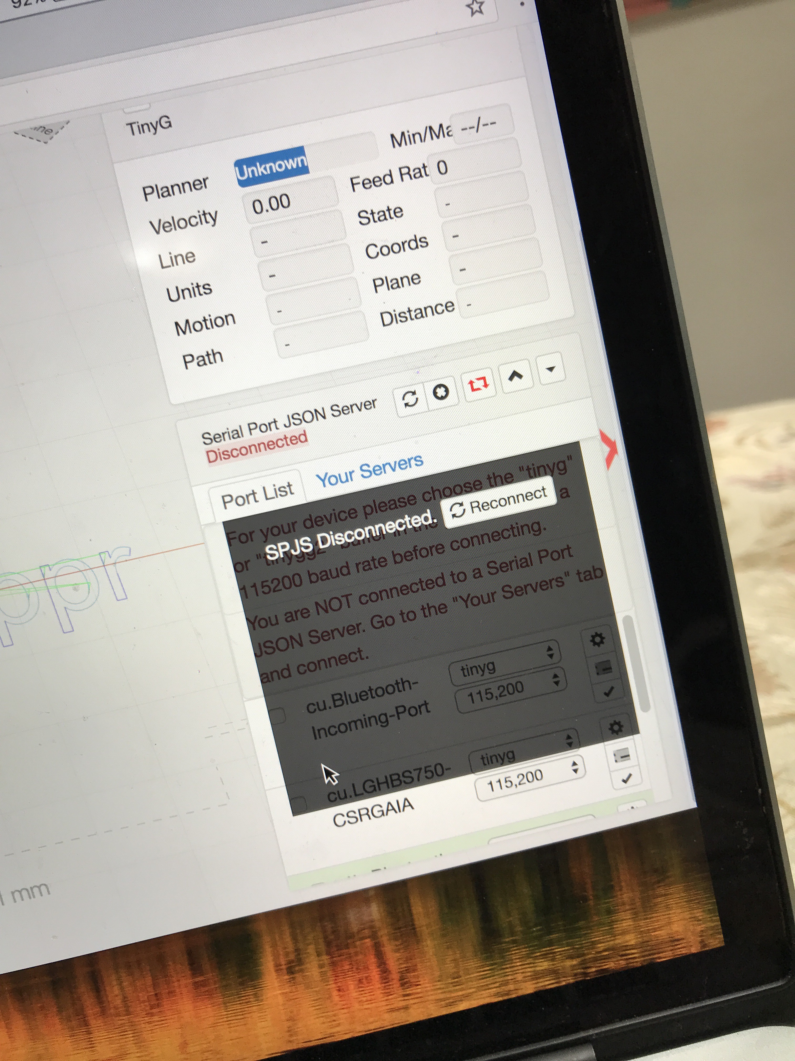

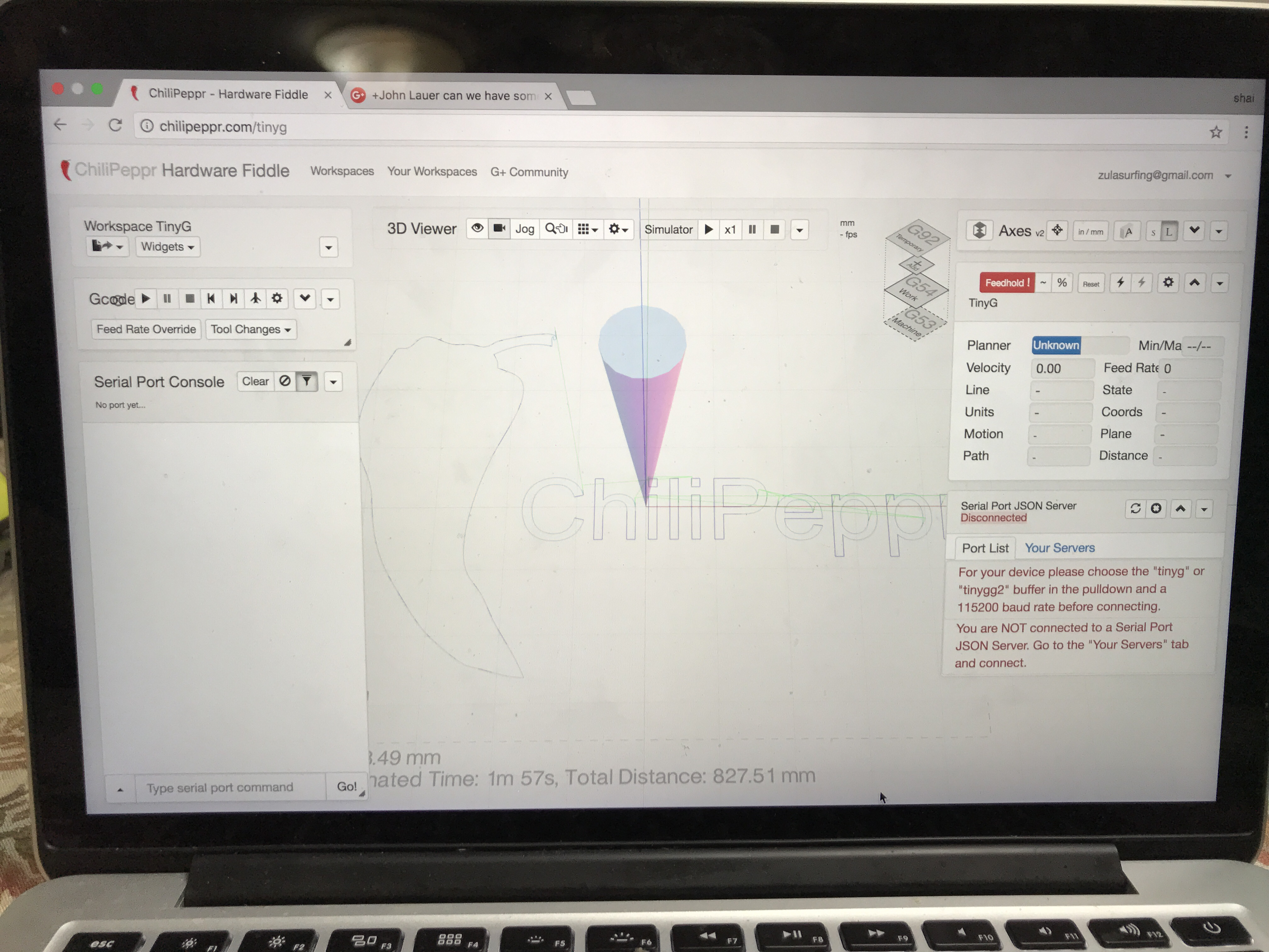

@jlauer here’s where we get stuck
@jlauer it automatically disconnected after the code was activated
Trying again but there is too much code than compared to the video @jlauer
You don’t need to build the code anymore. There’s a binary available in the servers tab
@jlauer I don’t understand
In chilipeppr in lower right corner is the serial port json server widget. Go to server tab and click download. Pick your operating system to download the binary and just run that downloaded binary
