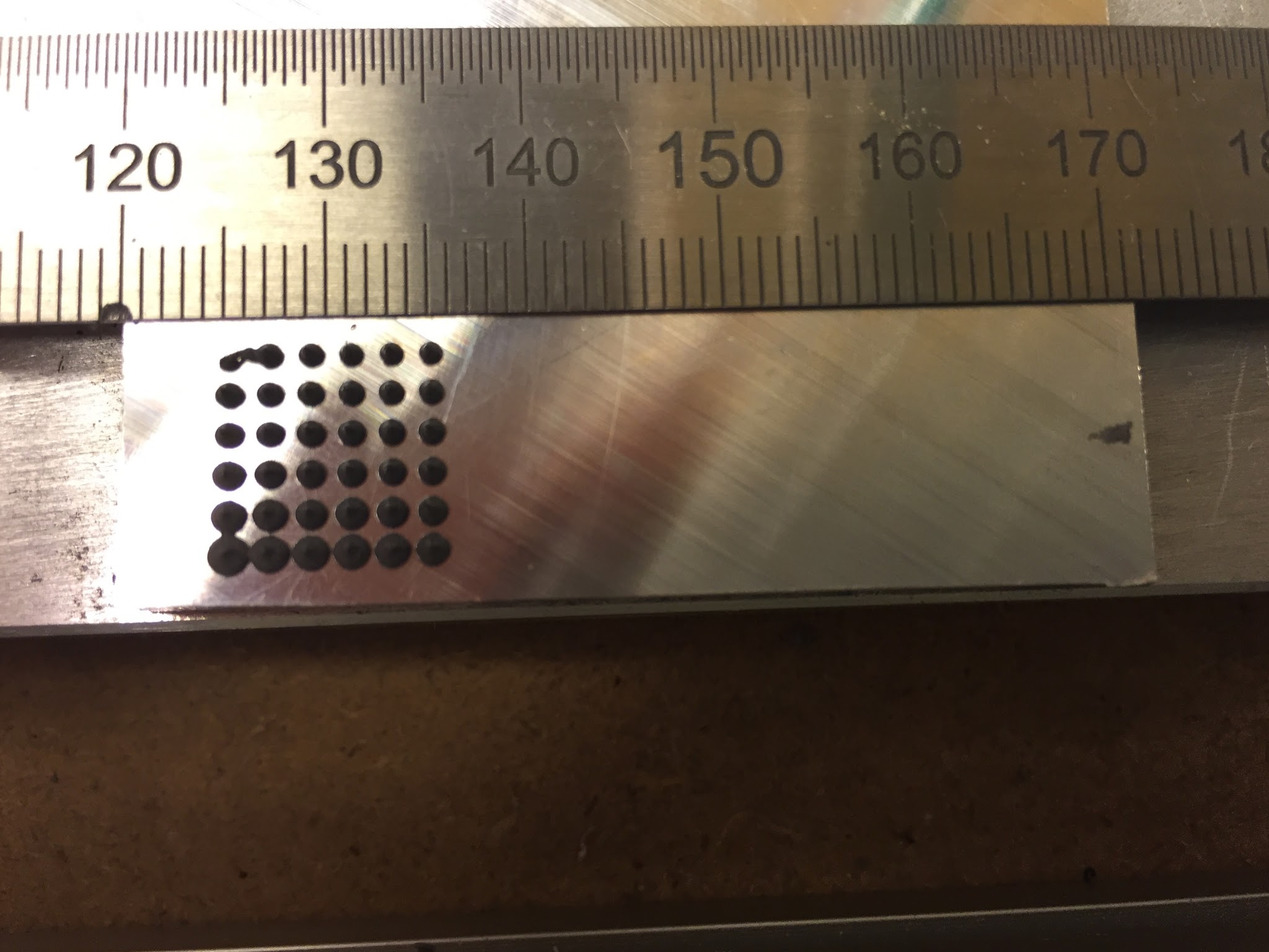

@jlauer Here an example to see how big are the drops. The issue now, the stepper press and the paste flow to much at start.
+Peter van der Walt Yeah, i got a lot of issues. I guess the quality of my Solder Paste are to wrong. I try with this matrix to find the perfect parameters to apply dots with the same Diameter every time. I check the china air compressors, IMHO good for manual dispensing, not for a machine.
