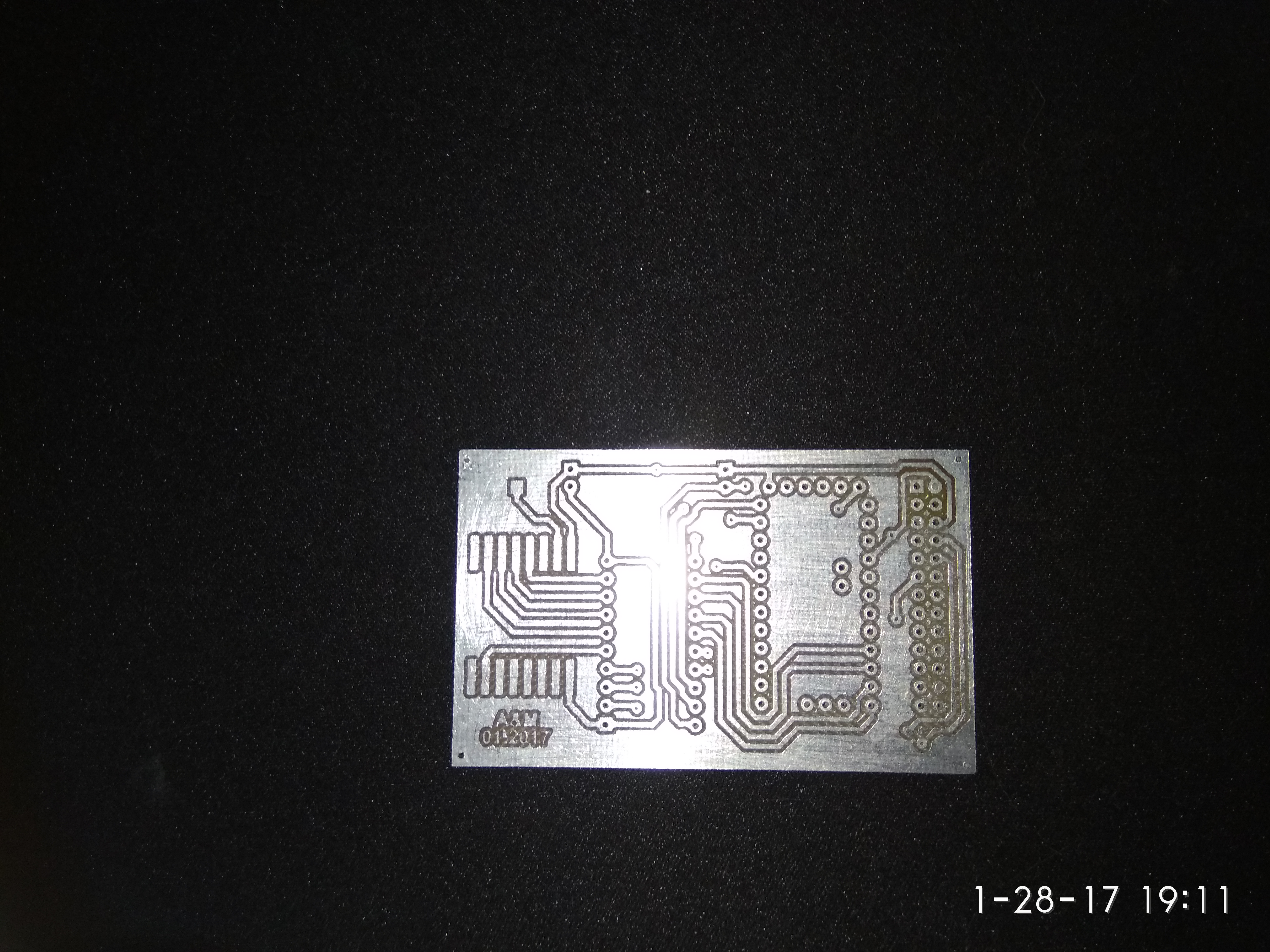

Double sided PCB made on the 3040T-DQ(ball screws) running GRBL 0.9j on Arduino Nano, TB6560 driver board. SPJS on OrangePi.
Engraved with 0.4mm 30deg Ti coated Chinese V-bit, 60000rpm 1400mm/min.
Tinned with plumber’s tinning paste and hot air gun. Large photos taken with phone, details with cheap usb microscope, what you see in the holes is paste leftovers, I should have washed it more carefully :slight_smile:
Thank you Chilipeppr!
By the way the GRBL deadlock bug is dependent on speed, with old spindle at 12000rpm I used 200-240mm/min and I got 3-5 locks/board face, now I got about 30-40 locks, I kept clicking the “~” button for the machine to work.
@Mircea_Russu ​ nice going! How do you plate the holes and vias?

@Justin_Adie I’ don’t plate the vias, I just cover the board in plumber’s tinning paste for copper pipes and blow hot air with a cheap gun I’ve bought for 10Euro, larger flow and not stressing my hot air workstation :slight_smile:

wow 1400mm/min it’s fast milling!
@Luca_Nervetti The 60k rpm spindle is worth every penny, it mills about eight times faster at 1400-1600mm/min, also water cooled and no fiberglass dust gets in the air so I can use a modified vacuum cleaner to blow it directly outside.

@Justin_Adie having the tinyg buffer would be great. In the mean time my approach coupled with the Gcode widget set to buffer max (20k lines) of code to the SPJS works. I’ve air milled 5 times the board in the pictures, only one lag point and I guess it was due to my laptop since CP freezed for a sec or two, I moved the mouse WITHOUT clicking anything and the job continued as expected :slight_smile:

ChiliPeppr strikes again! This time not even one single hickup!
hi - I never followed up on the plating question. if you dont plate the holes/vias how do you get connectivity between the layers for the different signals?
nice board - good to see things are working for you!
