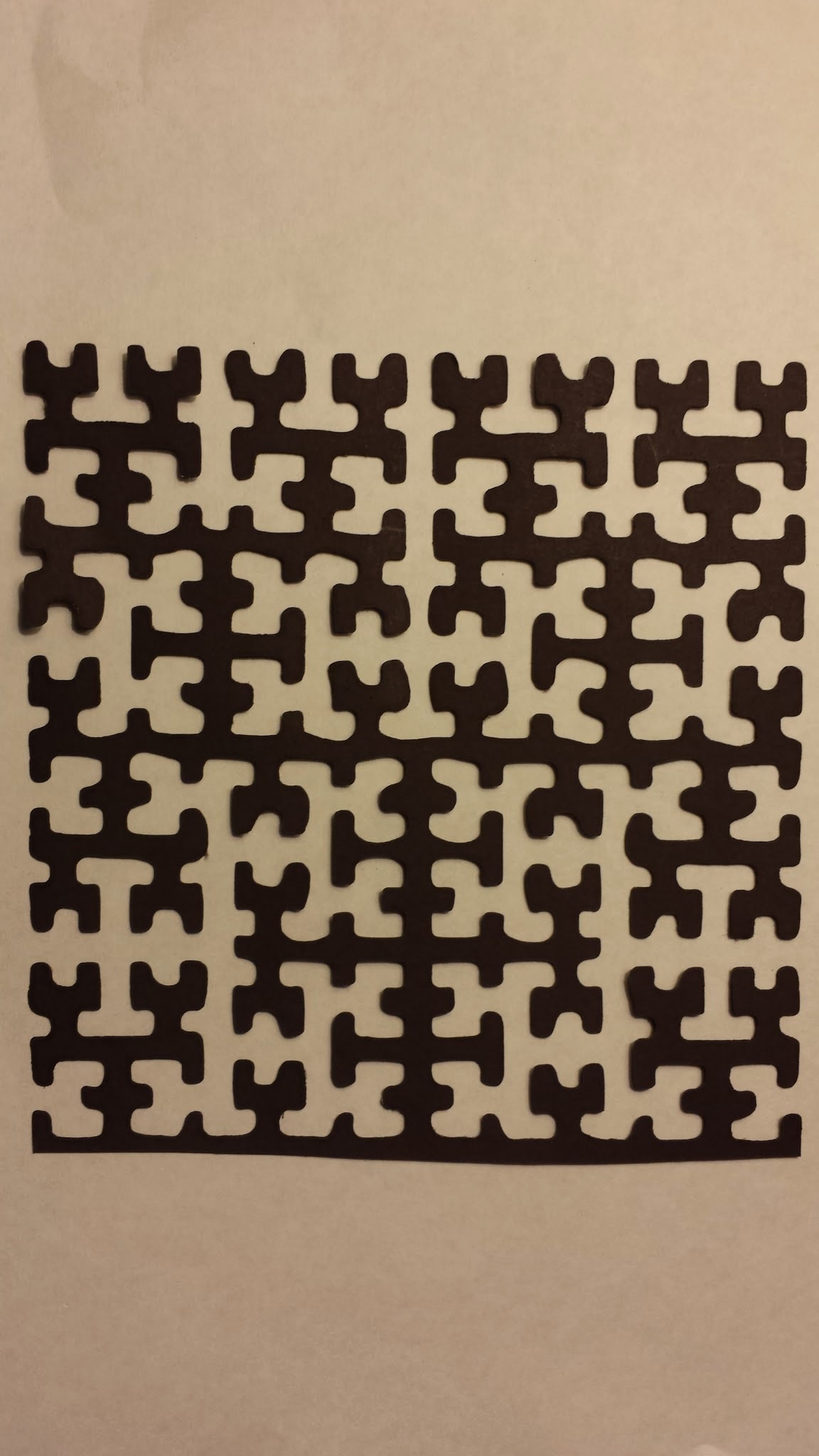

John - this was a fun paper board cutting from red and brown paperboard that measures 0.3 mm thick. Can also cut thru cardboard from boxes using the 2w blue laser - just have to be happy with really slow feed rates at times. These are both L-Systems, which comes builtin with Inkscape render extension.
