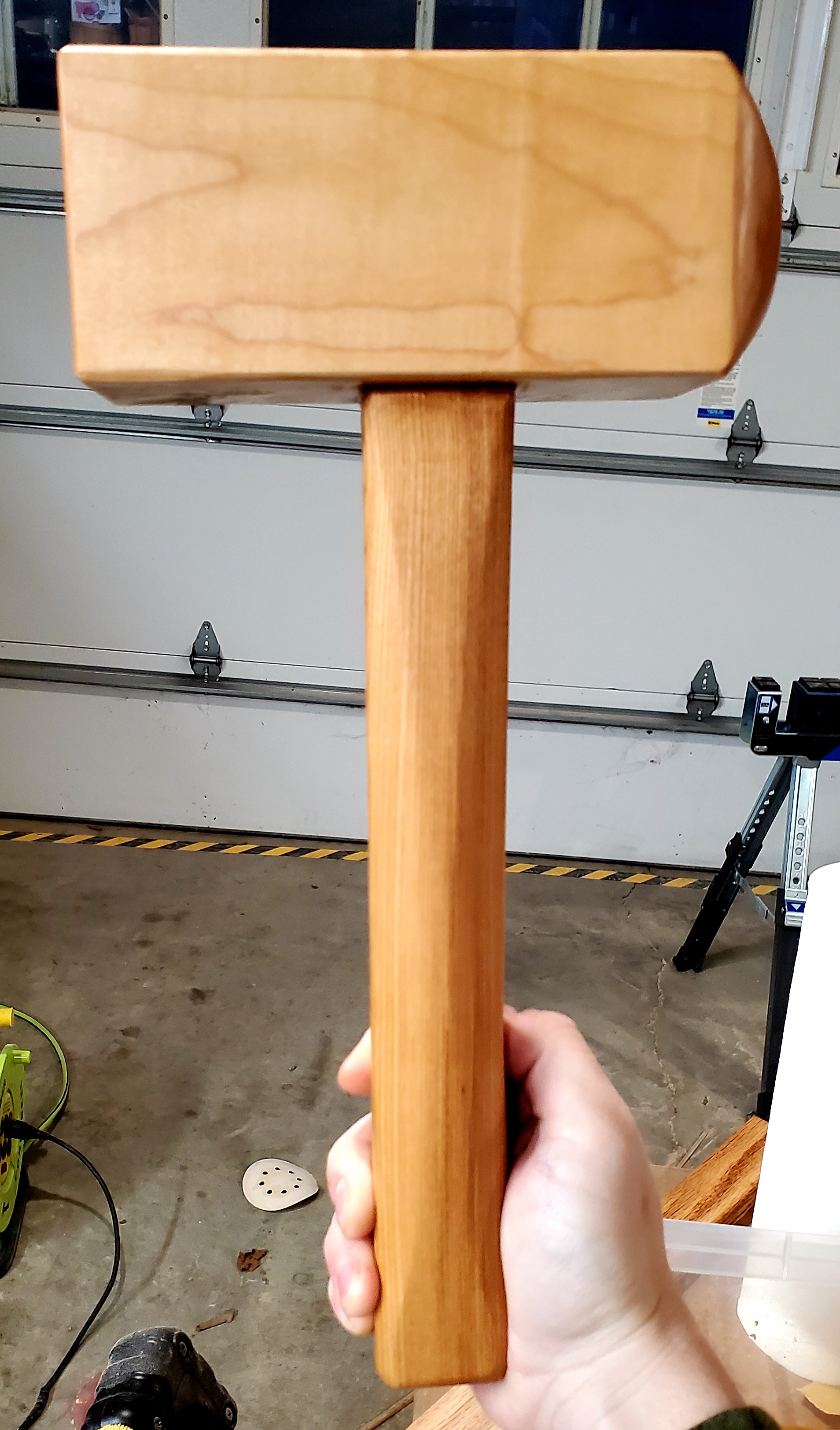

And here is the finished product (gonna take a while to dry since it is raw linseed oil).
Hard Maple mallet head with Ash handle, wedges made of Cherry. Bought the wood from my friends at Ocooch Hardwoods.
…is that as huge as it looks :)!
Nice work!
3inx3inx7in mallet head with an 11in handle
I think it can double as a shop defense tool. Now I have a laser and a bludgeon in the shop for protection.
I followed a plan that I found online. I didn’t realize it would be this big.

I weighed the mallet this morning. It is 1lb 10oz (737g).
Beautiful work.
