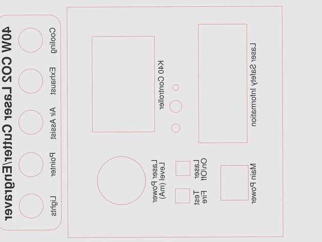

Jon Bruno Here are the files for the control panel, one is a cdr,
@Jon_Bruno Here are the files for the control panel, one is a cdr, the other is a svg

The CDR has the underly size of the displays in yellow lines. The SVG is ready to cut
Thanks for the compliment Jon. I spent about 20 hours playing with different designs before I was happy with this one. I painted the acrylic black before engraving and cutting with the painted side up Then I painted it white to colour in the engraved linbes, making the text really pop when viewed. Since all the paint is on the back side the front side is smooth, and the paint cannot be scraped or chipped off.
