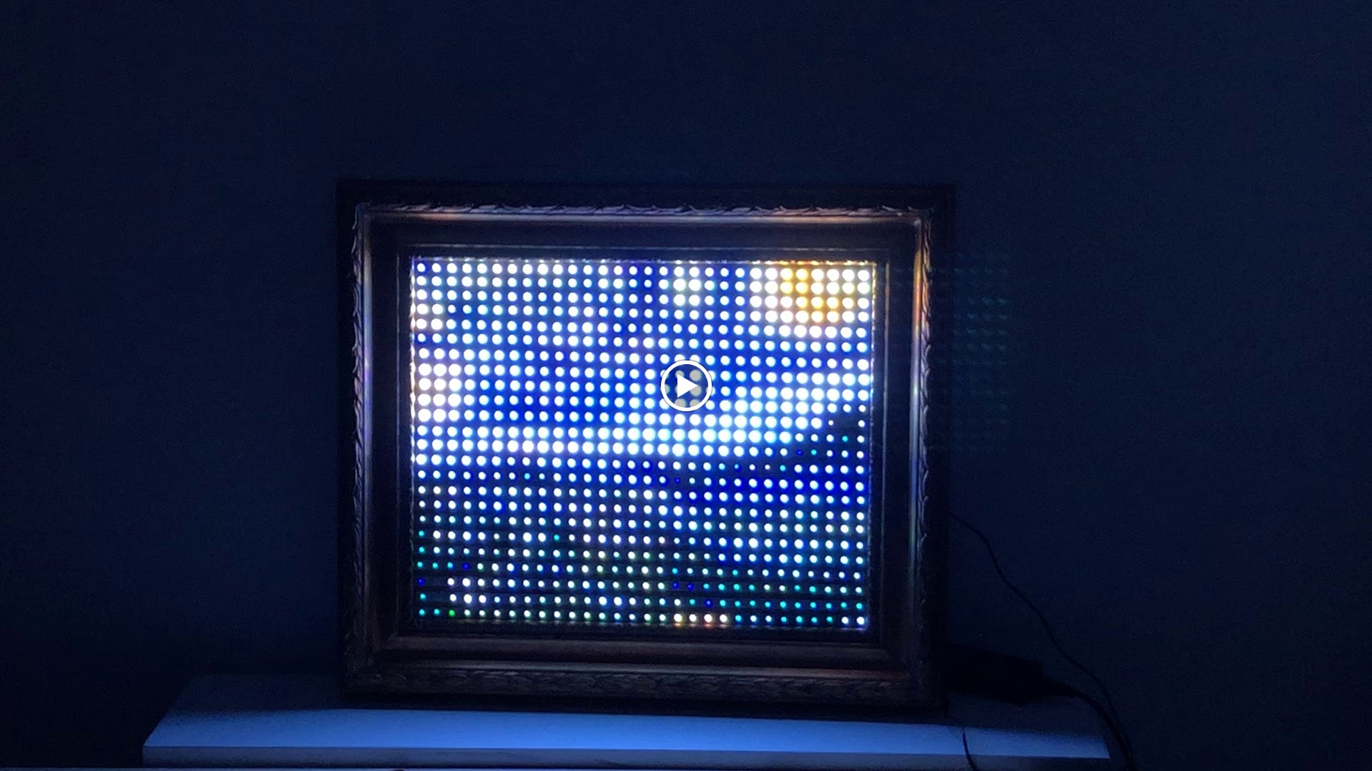

Just a bit of fun before the big one. Leds can be serve art too. :wink: 24x30 matrix +esp32. I had this old frame hanging in house

Is that 16 way parallel out?
It’s the same library. Here i use only 4 outputs for so little leds it would be too much lol. But I have prepared the card for the 16 outputs. But what is nice is that I can choose the pins that I want to use for the output in that case 2,4,5,12.
I will have a 4m1.60m (12048 leds) that I am gonna build
I will use all 16 output for that to keep a good frame rate.
I am building the frame now

For this, did you load the images on a SD card or into memory? Or are you reading from the serial port playing a slideshow from your laptop/computer?
@chad_steinglass i have put the images in memory but the SPI pins are free even using 16 outputs.
as you can select the pins you want
I woudl love to use SPIFF also but apparently there is an issue since the last update and SPIFF reading doesn’t work anymore on esp32. I had couple of answer to that in my mailbox and some tests to be done :slight_smile:

I can feel some interrupts issues when wifi is on I have a modified version to reduce this effect to almost nothing. I will commit when totally finished.
to totally avoid this I am thinking of two things
using a transparent latch like the hc373 or using fast SPI IC
feel free to bip me if you need help
