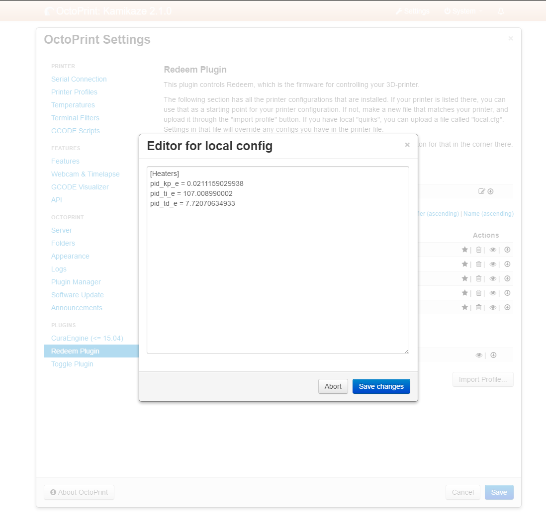

Here’s my local.cfg file before M500
And after. Last time my E-stepper values got changed which made the stepper just skip steps since the acceleration became to high.
