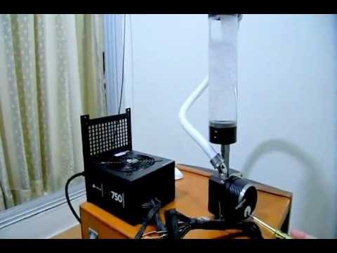

I’m not specialist but, by just placing container with fluid (water) higher will decrease lift pressure, that pomp need to generate. Perfect situation when water tank would be on the same level. That should increase flow rate and increase life of pomp. With that Chinese pomp that can be quite a lot.
You can always add second pomp and sense flow. if first stops switch to second one. Arduino nano + flow indicator + 2x simple relay shield for arduino + 1 termistor for measuring temperature on laser tube = redundant water cooling system… add 2 more terminators on water input and output and a little of math and You have pro water cooling sytem :slight_smile:
You can use flow sensor used for PC water cooling
http://www.thewatercoolingshop.co.uk/alphacool-flow-indicator-g1-4-with-rpm-signal-plexi-17176.html
Or simple
http://www.aliexpress.com/item/Flow-Scout-Meter-with-LED-light-And-Pointer-Thermometer-For-Water-Liquid-Cooler-System-CPU-with/32285104154.html?spm=2114.01010208.3.145.1MIbkg&ws_ab_test=searchweb201556_9,searchweb201602_1_505_506_503_504_10034_10020_502_10001_10002_10017_10010_10005_10006_10011_10003_10021_10004_10022_10009_10008_10018_10019,searchweb201603_3&btsid=322546db-5690-4ad8-8337-04e06ebb87cf
perhaps something like that pomp
Ha, I’ve actually got that exact pump (MCP655), albeit an earlier model, from an old PC water cooling setup I had. It’s rated at 50psi/3.5bar so prior to Scott’s comments I assumed it was too powerful for the tube.
I can’t really move the tank as it’s quite large (25 litres) and I don’t have the spare bench space.
I’m quite happy with the <2 second cut off, homemade switch, so will stick to the current setup. I’ve wasted so much time lately setting things up, I just need to get back to lasing…
I think the rating on the PC pump refers to the static (overall contained system pressure) not what the pump will generate. Most PC cooler systems are sealed and can build fairly high static pressure from water expansion, thus the rating. Flow on them is pretty small. 50 PSI is indeed way too much for the tube, I’d keep it under 10 psi MAX - which will take a rather large pump to generate with an open discharge. The stock pump is good for around 5psi at shutoff which is equal to 11.5 ft of water If I recall what the box said)
