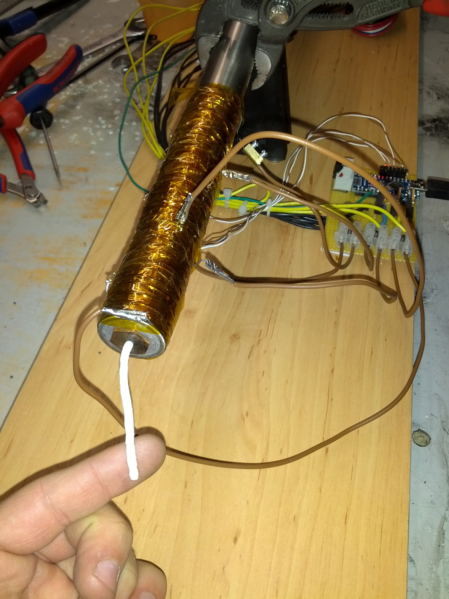

Just as my extruder starts spitting out its first ugly bits of “filament”, Hugh Lyman scores the $40k award. Congratulations and thanks for the inspiration!

@John_Bump one of the ideas I’m still pondering is some kind of contact-less filament diameter measuring system (+feedback) . I’m taking it step by step, though, topmost priority is getting a consistent extrusion first.
@Sanjay_Mortimer I got the Polylac off of eBay - some guy had some sitting around. It’s 747S, not exactly a high-flow variant, but rather a high-strength one. Everything in my extruder is struggling to keep up with the extreme pressures this blend needs. Next up is a proper blend with nicer flow properties - I’ve found that many of the plastics distributors are happy to sell small quantities of ready-made plastic to private folk.
