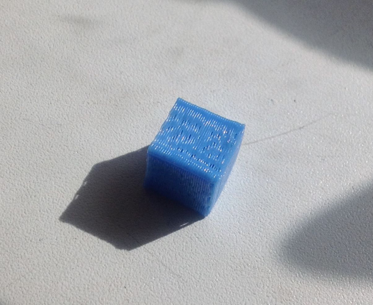

Just build my first 3D printer. Seems working fine, but I noticed some spaces between layers. Is this normal? If not, how this can be fixed? I’m using PLA, speed is 100mm, temperature is 220C. Leveled heat-bed with paper sheet.
Looks like under extrusion, have you checked the calibration of your E step?
Hmm, no. I will check it, thanks.
make sure your filament is set to the right diameter.
Also, 100mm/s seems a bit fast for a first print. Try starting at 50 and go from there when everything seems fine
Is it an i3?
@The_Hozza yes.
I printed anover cube with low speed (35mm), and it looks much better.

Also I tryed to calibrate extruder, using straw and marker, and found instead 100 mm extruder takes only 90mm of plastic. But EEPROM menu of Repetier Host is inactive, so I can’t change this settings. I wonder, why it is so?

First of all 100mm a second isn’t good for starting out. I still print at around 30 sometimes if I’m willing to wait. That’s where you should start. Your hotend might not be able to keep up with the speed so your extrusion rate might be too low. I would stop down your speed first and then see what happens.
@Vladimir_rvo_va_r in your configuration.h file is a setting: (i think it’s called) eeprom set: 0 or 1 or 2. You can find it as well in the configuration tool from repetier. Should be at least 1, depends if you want to overwrite or keep eeprom settings.
I see. I heard maximum speed of such printer is 150mm, so I thought 100 is not so much.
