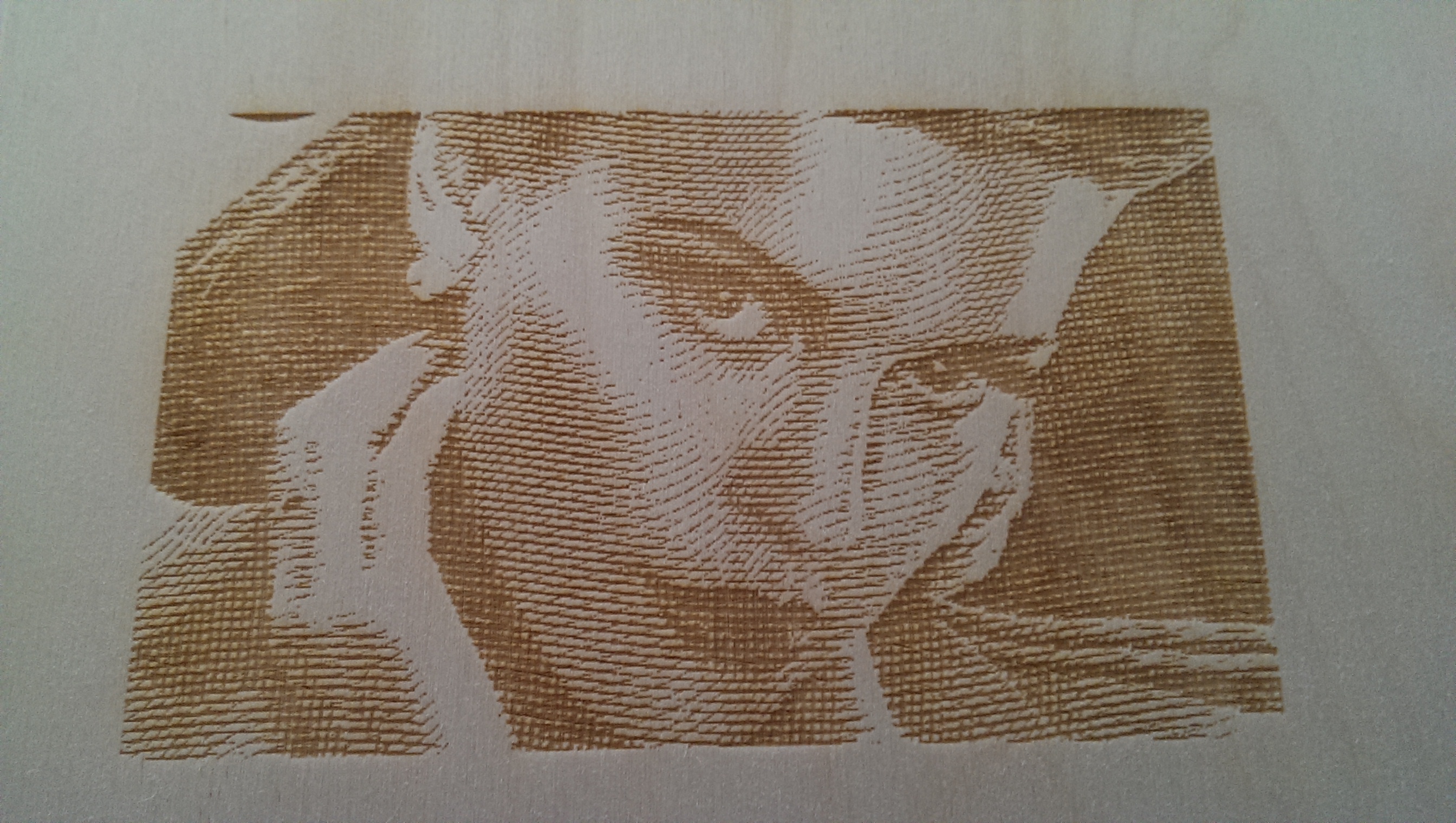

Just checking out some faster settings…turned out pretty good as far as I’m concerned.
Dude! Blade Runner right? Very nice, I like this one the best!
Yup
My favourite film of all time !
What speed were you at with this one, looks great ?
400mm/s
Fast! I thought the limit on these was 350, but i read somewhere else it’s 500.
Mine is 500mm/s…my power stays around 6 when I’m engraving and 8 when I’m cutting.

Good results, what speeds ?
No…I have m2 nano board…I use coral laser.
4mA at 400mm/s
