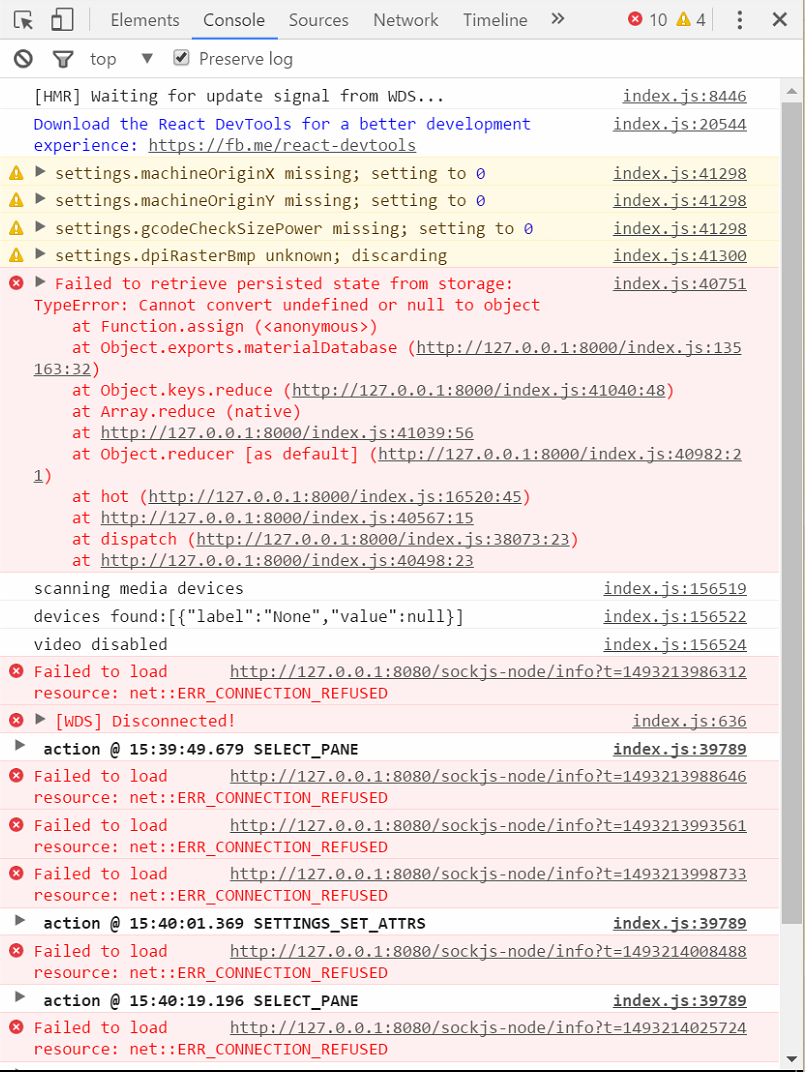

BTW: I’ve started DevTools, and the only thing I see, whenever I try to open an SVG is this message:
GET http://127.0.0.1:8080/sockjs-node/info?t=1493060125399 net::ERR_CONNECTION_REFUSED
in abstract-xhr.js:132
PS: Same error opening a workspace…

@CescoAiel I just added some extra logging to the live version to try to narrow this down. Try loading an SVG file and post the console log. I’m looking for the entries which start with “loadDocument:” and “FileField:”.
