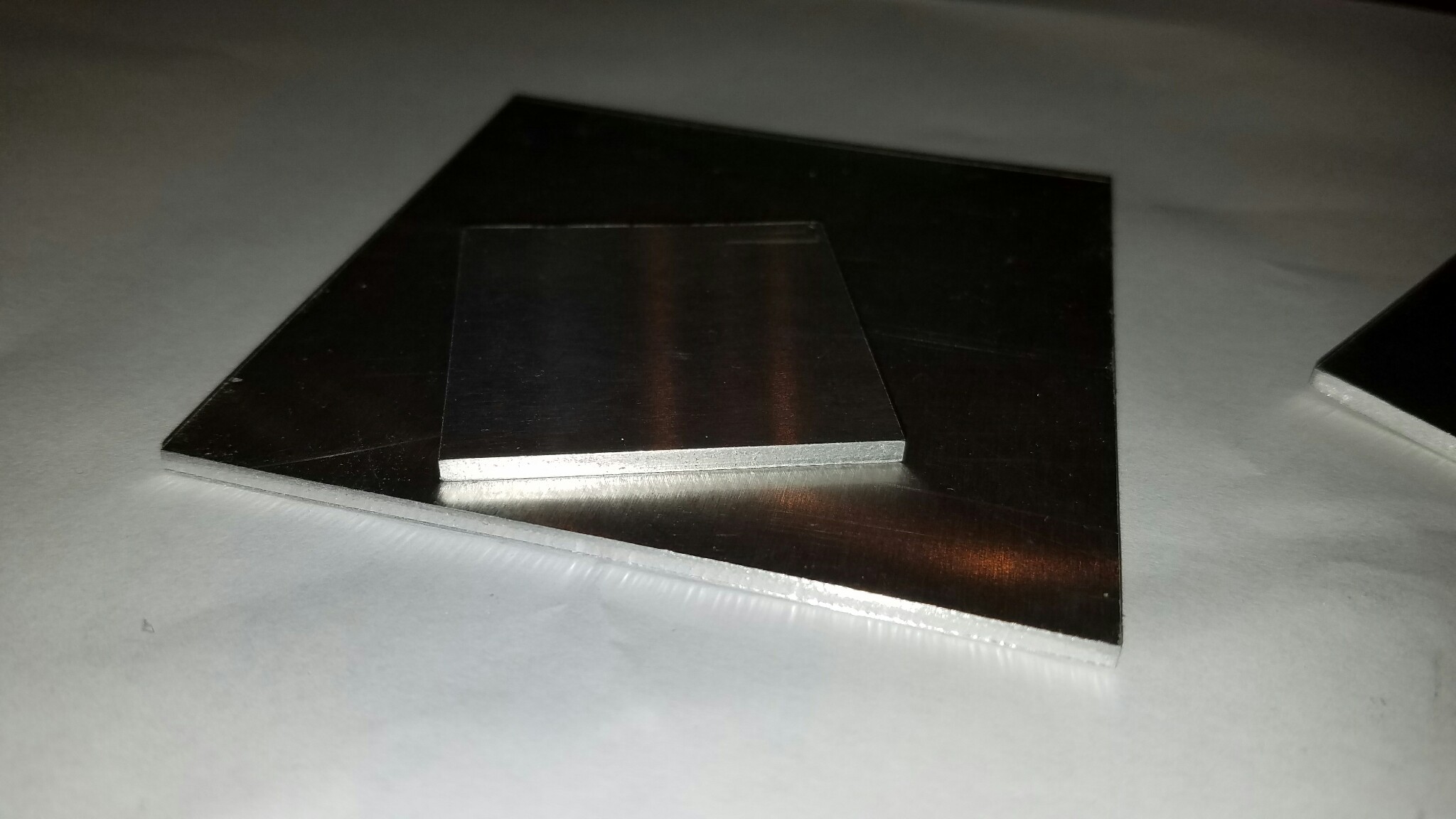

The tool I stumbled upon is the following: Destiny Tool V30805S (http://www.destinytool.com/viper-dvh.html). I’m much too slow but have been at about 9,000rpm, 0.25mm DOC and about 275mm/min. It’s understandably producing small slivers of alu - time to up the feed rate. The finish at that cut spec is great though. Chips staying in the cut channel hasn’t been an issue so far - but it’s been small test cuts. Having said that, the tool is still sharp and seems to cope well… time for more experimentation on feed rate.
I went hunting for more info on my specific bit yesterday and came across this: https://discuss.inventables.com/t/production-level-aluminum-milling-with-8kw-water-cooled-vfd/13557. Looks like the bit I’ve got is actually pretty good. I found the feed/speeds used as " I cut at about 18946RPM with .30mm DOC at around 300MM/M speed and get super smooth sides on all my cuts. with air blasting like you to keep the cuts clean also.". (this is closer to what I’ve been using). Thoughts? Or is it just a case of ‘if it works for the tool…’?
