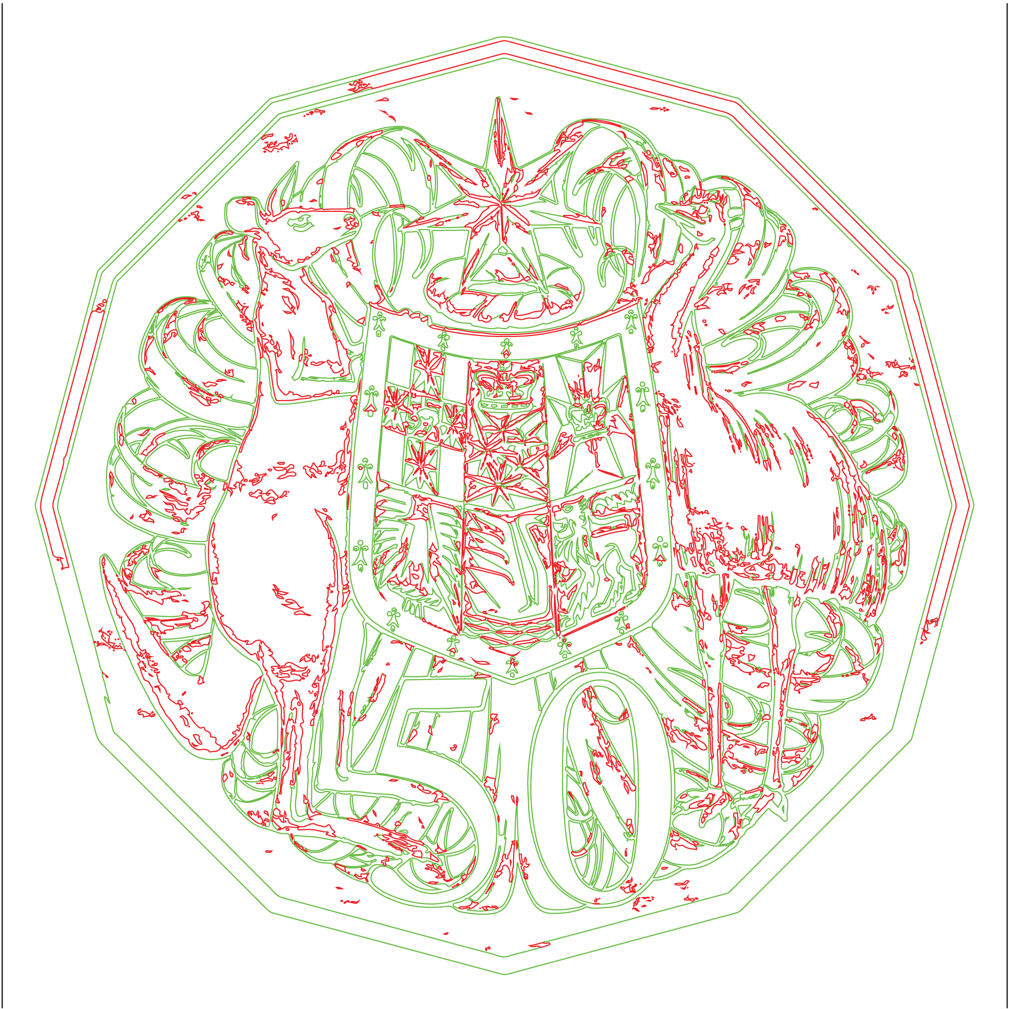

Just did a test cut of this image with CorelLASER.
I decided to test if I can make the separate cut layers different colours & whether Corel will recognise them & convert to black, or if it will do something odd. So far, it’s still cutting, but it seems that it has no problem recognising the two colours & they are both converted to black in the cut dialog window.
This is useful to me, as sometimes I am using multiple layers & it gets difficult to tell which is which & select the one I want when they are all the same colour. Thought it may come in handy to someone else.

@Tony_Sobczak Yeah seems to be good. I had just been using lots of black layers. Quite confusing. Much better to be able to colour them. I don’t know why I didn’t even think about this or test this til now.
