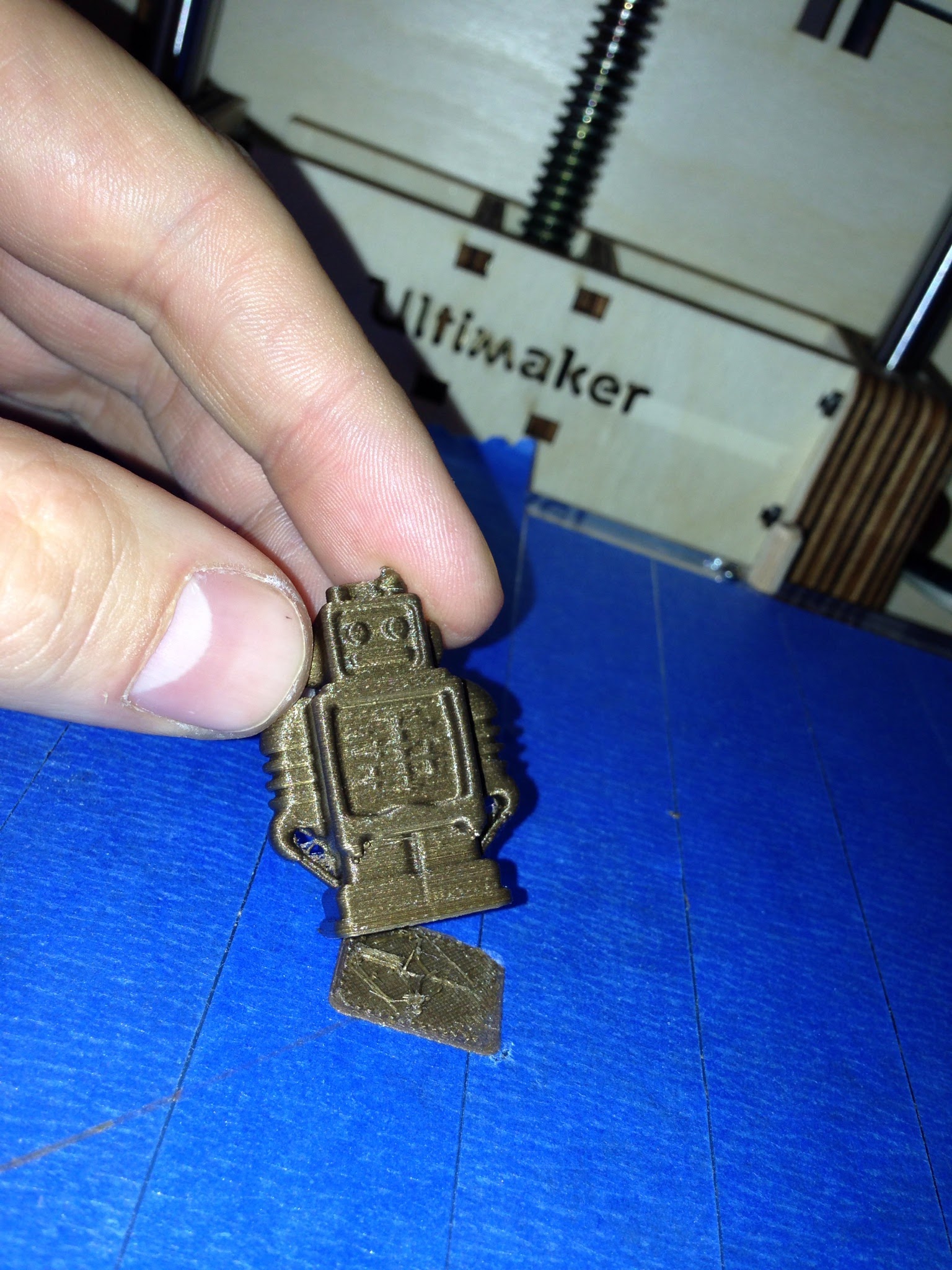

Just did my first print. It wasn't perfect but still ok.
Just did my first print. It wasn’t perfect but still ok.
Unfortunately, the foot of the robot broke when I was removing it. What did I do wrong? Should I perhaps put rubbing alcohol on the painters tape?
The good news is it stuck well! I have been using a guitar pick lately to un-wedge the model from the base, but anything wedge-like that will get under it will work. You will be happy you have that kind of stickyness when you build bigger models. :slight_smile:
Thanks. My second print came of easily using a metal butter knife. Happy :slight_smile:

Looking at the surface quality of your part and the overhangs, which is actually very good. There is no way that’s PLA at 225C, at least not any PLA I’ve ever used.
It is Ultimaker’s own brand of PLA
@Bracken_Dawson @Peter_Parnes Ultimaking Ltd sells PLA made of ingeo 4043D (the standard with 4032D) whose melt temperature is 210±8°C.
