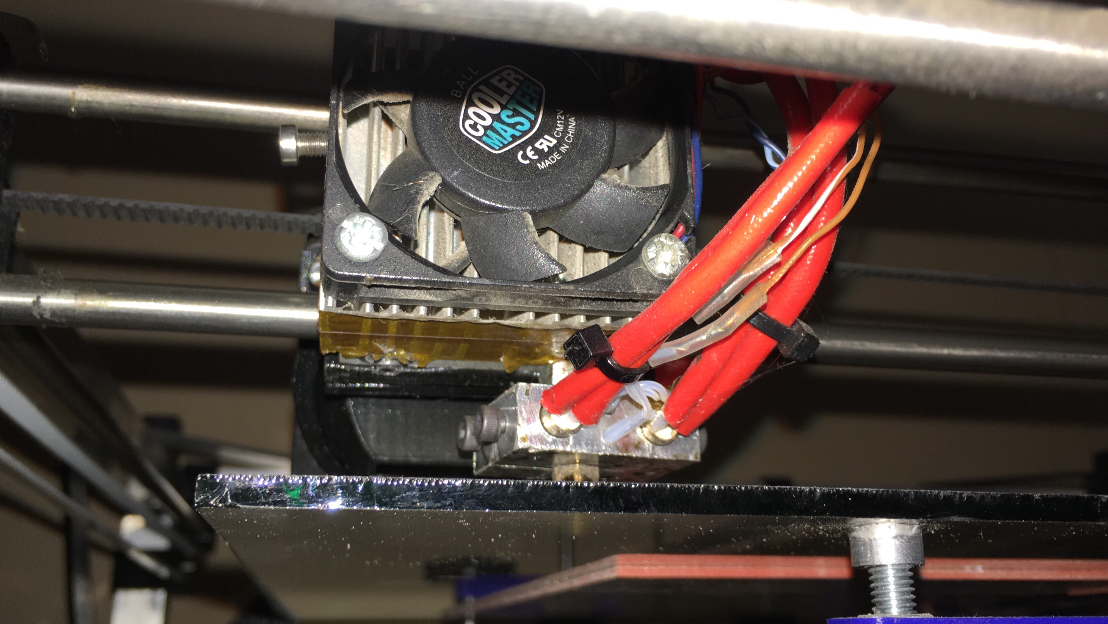

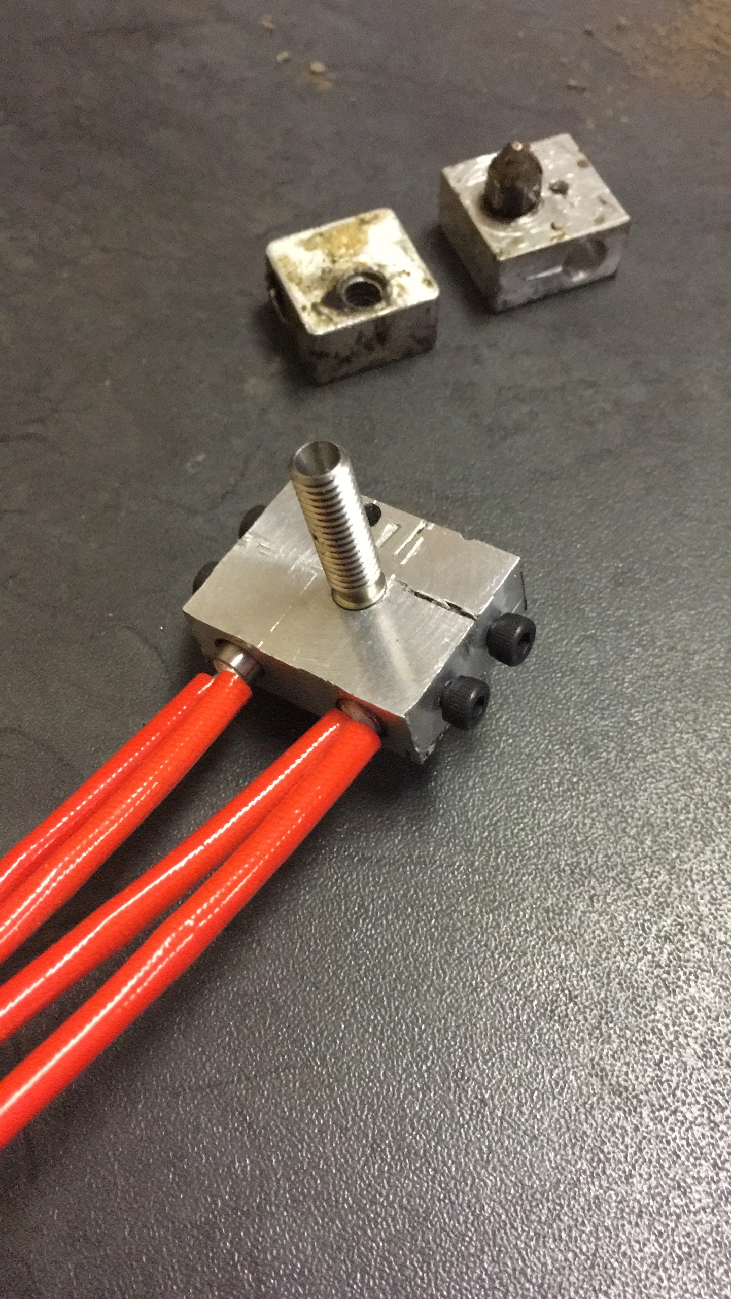

Here’s the one I made.
Machine was built as dual extrusion but removed 2nd nozzle to make a 2-1 Y piece both Heaters run independently so can heat up just one. Machine still thinks it’s dual extrusion. To get to higher filament feeds I need to convert to 3mm and can then probably go bigger than 0.8 but I can say it needs a longer melt zone to keep up.
If you can figure out the energy in watts needed to melt filament per mm you can figure out the power and heater capacity needed to melt the desired Filament (it’s how someone explained it to me, I have no idea how)
The two heaters where stable enough to complete a 54 hour print
