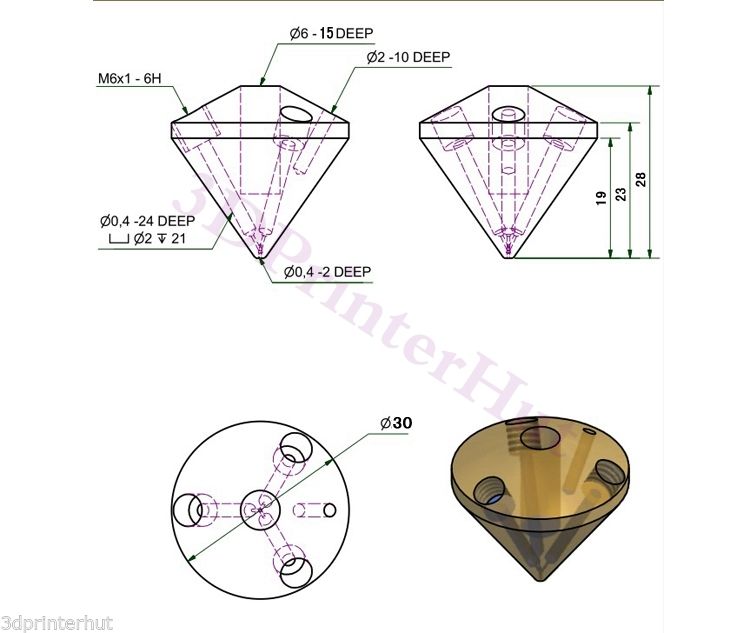

Just doing brainstorming at big but cheap diy-extrusion: Has someone already tried to enlarge the nozzle of a diamond hotend by drilling to a size of like 2mm, then feeding 3-times parallel the same filament through to reach a high output/flow? It is probably needed to add additional heaters, but besides that, could this work?

@Aaron_Spaulding For first test/try, I planned to buy a 6$ diamond hotend, drill the nozzle to like 2mm and push via 3 bowden-extruders with mirrored separate stepper drivers. Maybe I am going to drill additional holes for additional heaters to keep temperature. Color mixing could be a side-effect, but it is absolutely not intended and not planned either. It is just for cheap-big-extrusion.

@Rene_Jurack I think it won’t work. Problem will be lenght of the 2mm hole in your nozzle. You need 2xdiameter lenght of the orifice to get laminar flow out of the nozzle, but you can always try
One question I am wondering is if the back pressure of the smaller outlet of the standard diamond is a design feature that will be lost when opening up to 2mm. Probably not since you usually open up at the union of two or more incoming flow paths. But worth thinking about.
