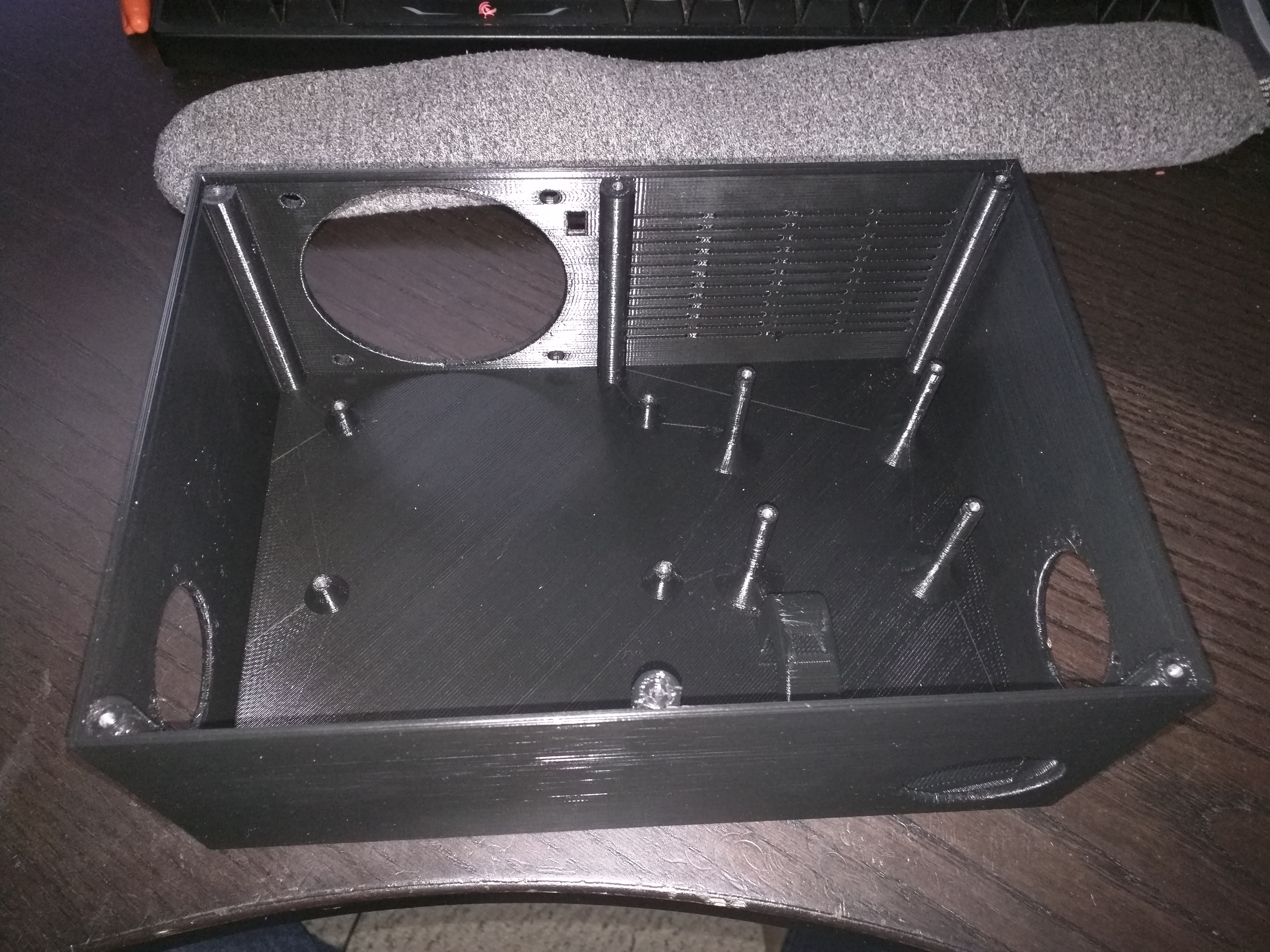

Just finished a printable electronics case for my herculien build. I’m pretty happy with the results.
Lots of cooling power there. Great job.
I had a couple prints on my RoBo 3D fail because of thermal protection so I figured two 40mm fans sucking in cold air and 1 80mm fan pulling it out over the controller should be more than enough to keep things cool. I put the vents in there to allow the raspi to get a passive airflow over it caused by the vacuum effect the larger fan will create. And it looks cool too.
I’ve also made a raspi camera mount to attach to the case too. I just need play with the design a bit.
