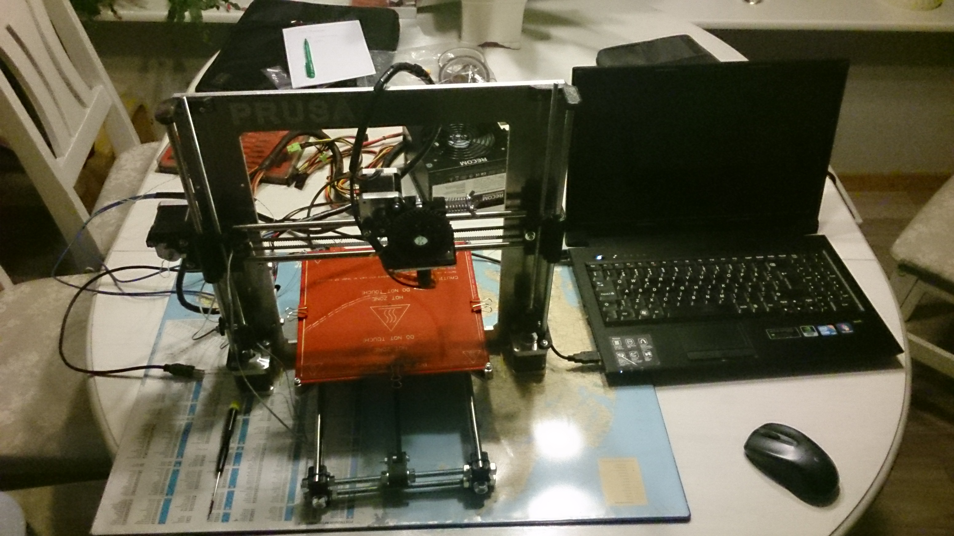

Just finished Building my Prusa I3 from Reprapuniverse with Sanguinololu controller board.
Just finished Building my Prusa I3 from Reprapuniverse with Sanguinololu controller board. Anyone who know witch program I should use to run the printer?

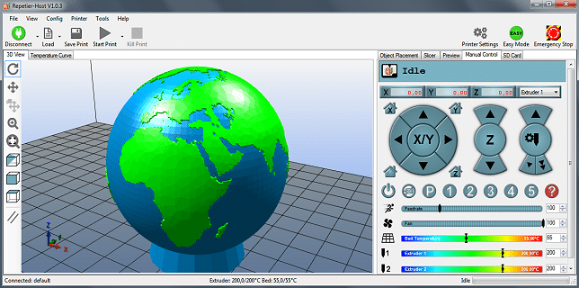

I like Repetier-Host for controlling the printer. You can load the STL, slice with Slic3r and print all from the same application.

Repetier-Host for the front end application, or even Cura. Cura is also the slicer, but can act as a front end. If you want to use slic3r, Repetier-Host adds the ability to rotate object models and visualize gcode.

Repetier Host has more functionality, I’ve found, than Pronterface. It has real time build visualization, tweaking of EEPROM settings and real time tweaking of flowrate and feedrate
