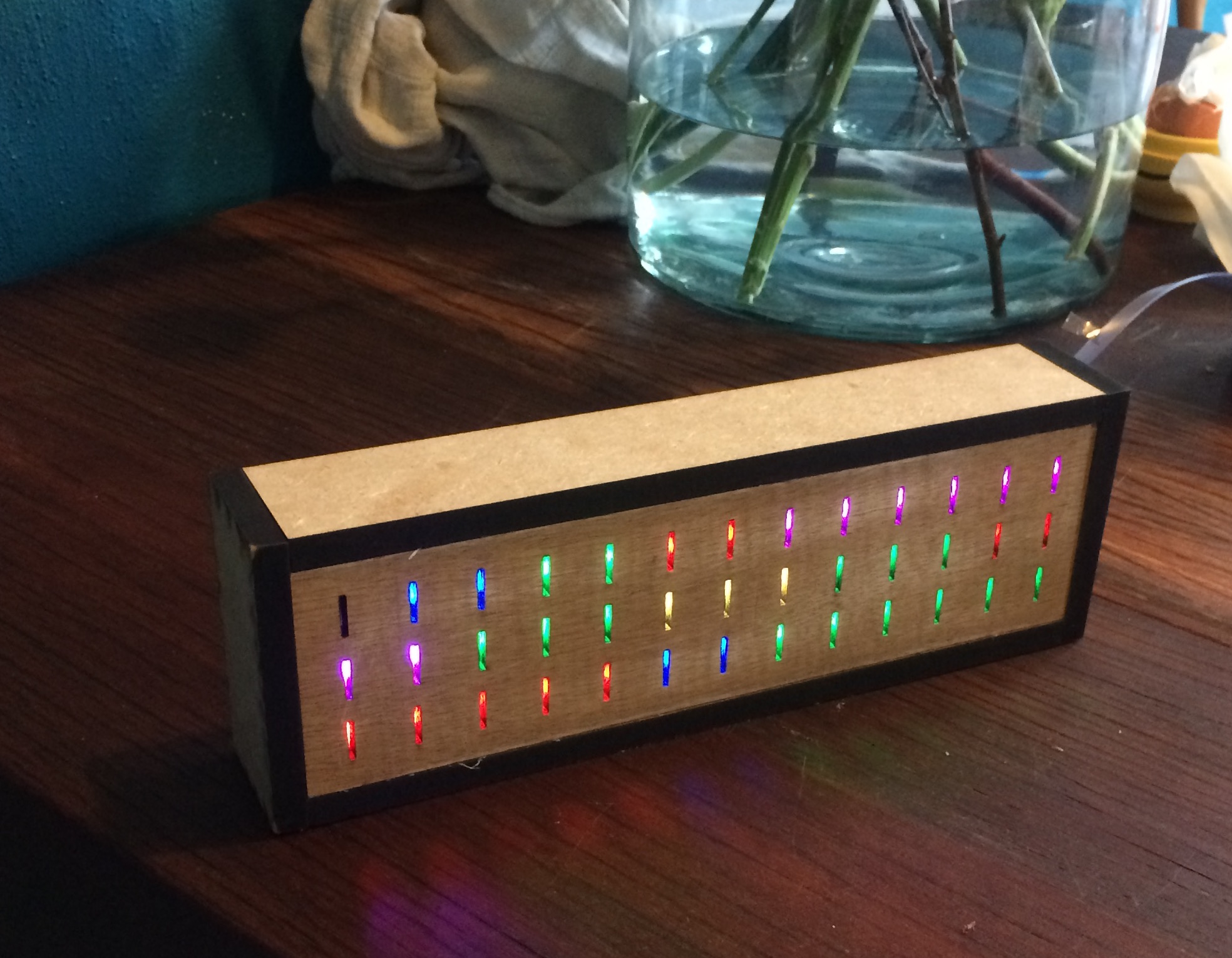

Just finished my wind prediction Clock.
Just finished my wind prediction Clock. It shows the wind prediction, based on the WRF9 windmodel. Yes I’m proud. But… this is not running with FastLed (I now use the Adafruit Lib). I cant get the FastLED to show me anything. Even the blink example of fastLED will not light up any led.
