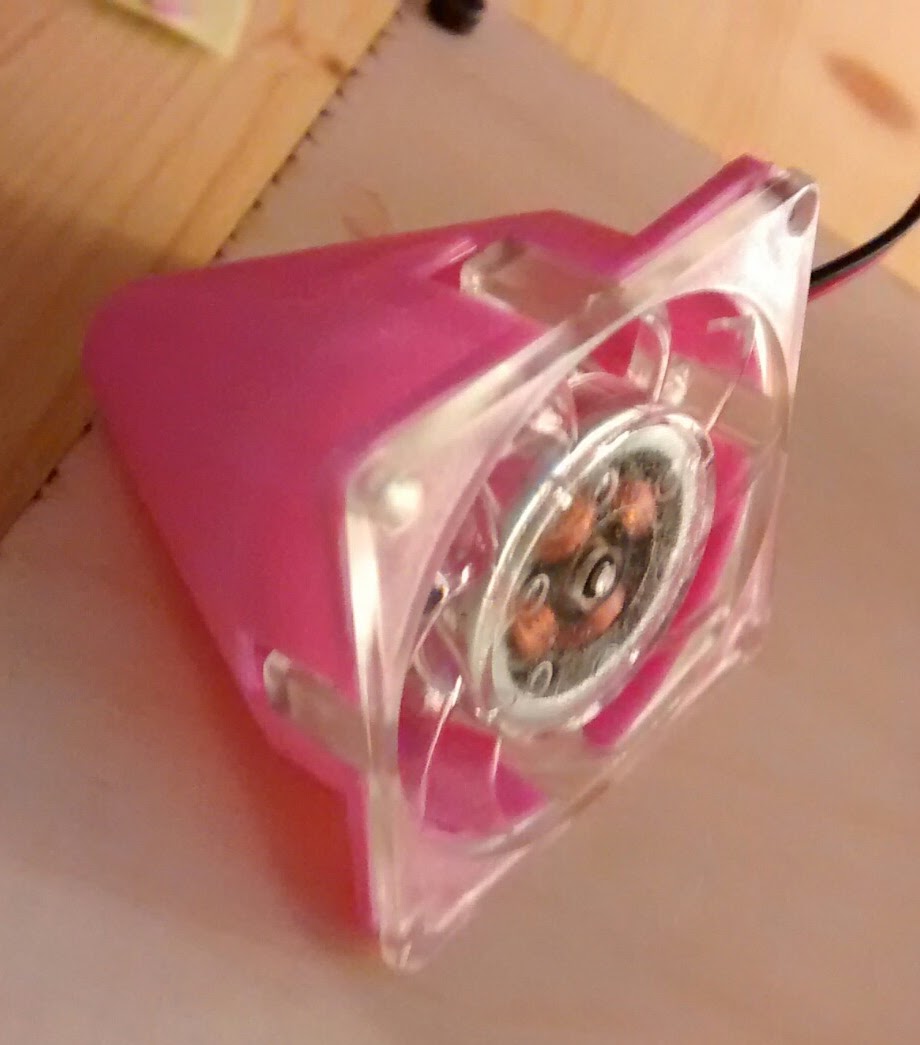

Just finished printing my first own design! The screw holes are too small,
The screw holes are too small, the fan itself is blocked and the nozzle would hit the print bed…
But hey, I made this. And as a software developer I’m used to debugging. :smiley:

The holes on my prints usually come out a bit too small as well. It seems to be a common thing to either have the outer or inner dimensions correct. For now, I just fix up screw holes with some drill bits I have epoxied to (printed) handles.
@Carlton_Dodd yeah, I was thinking along those lines, too. But as I’ll have to print it again anyway, I’ll increase the hole diameter by half a mm. Oh and thanks!
@Carlton_Dodd yes, OpenSCAD it was.

Very cool! I imagine you’ll find that is too much “choke” on the duct. I printed out some similar ducts in various configurations and found that if the opening of the duct was less than maybe 1/4 of the size of the fan (diameters) then the back pressure reduced the air flow significantly (I had two fans of the same size, so experimenting was quite easy). Worth experimenting with.
