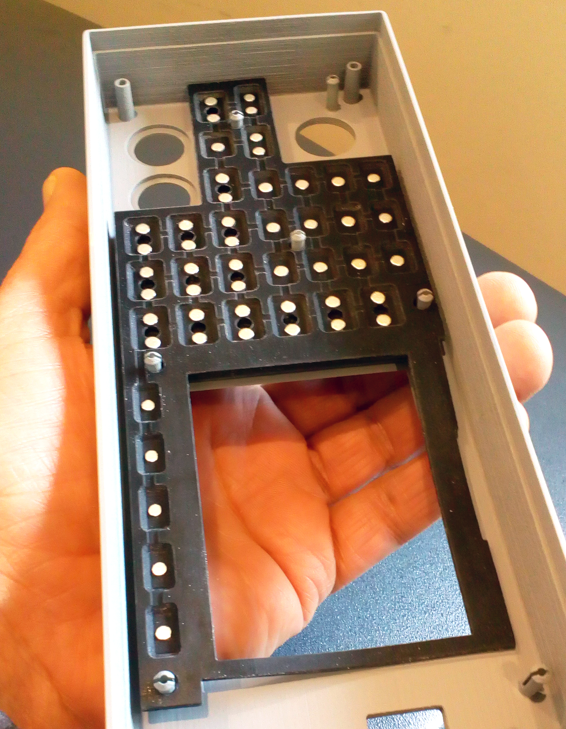

Just finished this 3D printed instrument panel complete with 3d printed rubber keyboard with conductive keypads. all painted up and ready to function just like the real thing will do.
What are the conductive pads ? Silver paint ?

HI henner, Yes bang on! Three coats of conductive silver paint; works really. When you are applying the paint you must keep the liquid agitated, so it does not settle out.
Awesome! I love replacing and customizing stuff with 3D printing, can you provide the source?

Why rubber? It’s been inroduced to make keyboards manufacturing cheaper. With 3d printer you could do better.
You should have flipped it over for a front panel shot! Looks great from this angle though.
You printed the rubber? Which filament? Printer?
Was it made on an Objet?
are those electrical contacts just like the ones inside my remote control for cable?

@Carsten_Wartmann Hi Carsten, The rubber simulant keyboard was printed on a polyjet system from stratasys.

@Martin_Luther Hi, Yes pretty much, they were hand painted with conductive silver paint.
@Alex_Koukarine Hi Alex, Not sure what you mean. All parts in the image apart from my hand were printed on a 3D printer. The keyboard made from a rubber simulant called Tango Black plus FLX980. The shell printed in Semi Transparent 720 then over sprayed with acrylic paint. To produce a mould for the same keyboard for evaluation purposes would cost around 7/8 grand, this keyboard came in at £71.00 and it is fully functional as the design incorporates key button return skirts.
