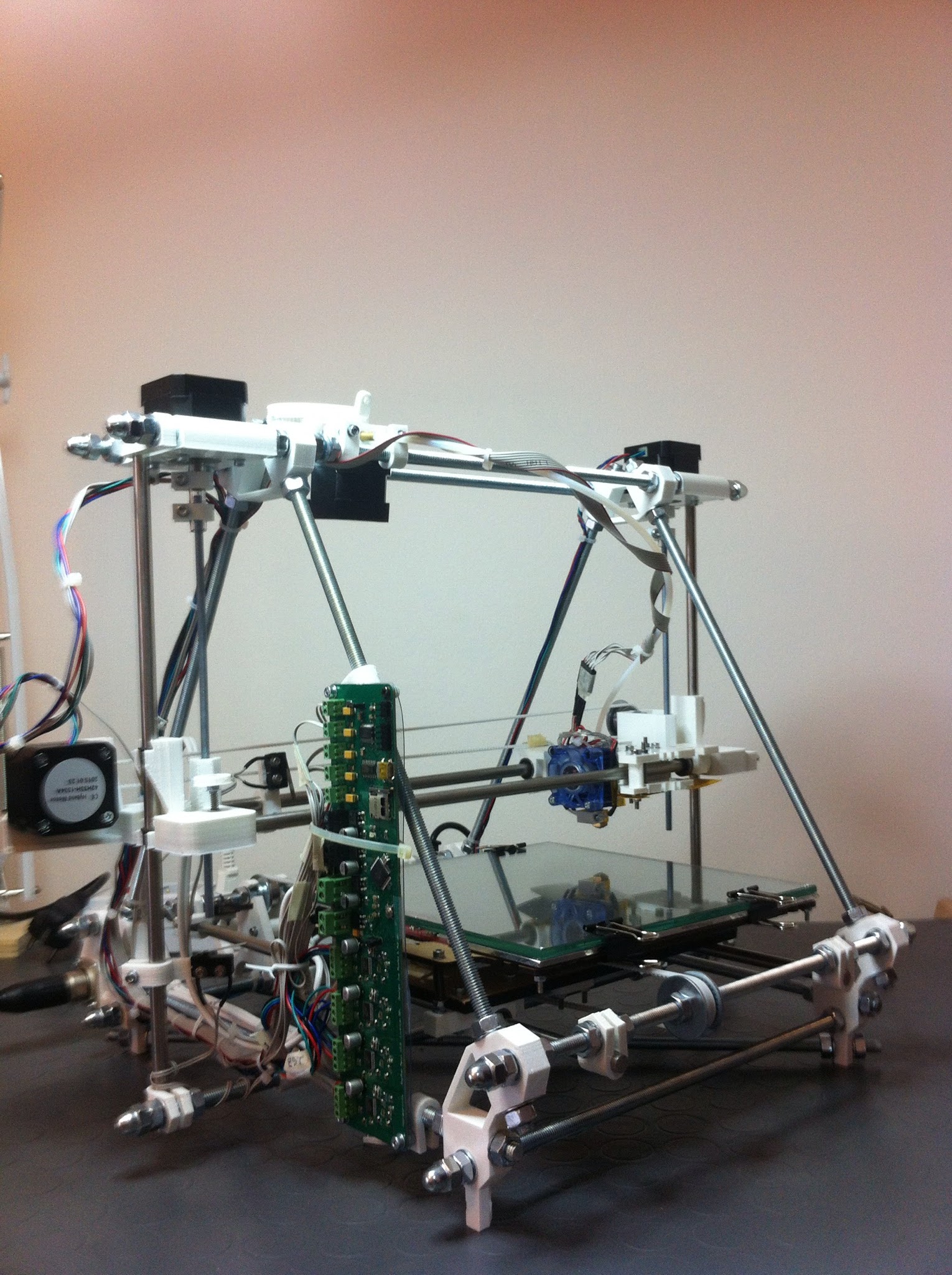

Just finished to assemble my RepRapPro. NEXT STEP: Align and fine tune.
  • Rebuilt the extruder connector: due to false contacts
  • aligned the bed & axis
Learnings: care at the z axis end stop. During alignment I didn’t block the screws and on homing the z–axis the end stop suddenly drop down (by gravity) the motor did not stop, and the entire x stucture crashed on the bed not destoying everithing just for a chance and my quick power turning off.
I would like to had the PANIC button !!
Afert the crash I had to fix the structure and realign again.
NEXT STEP: Extruder test & first print
