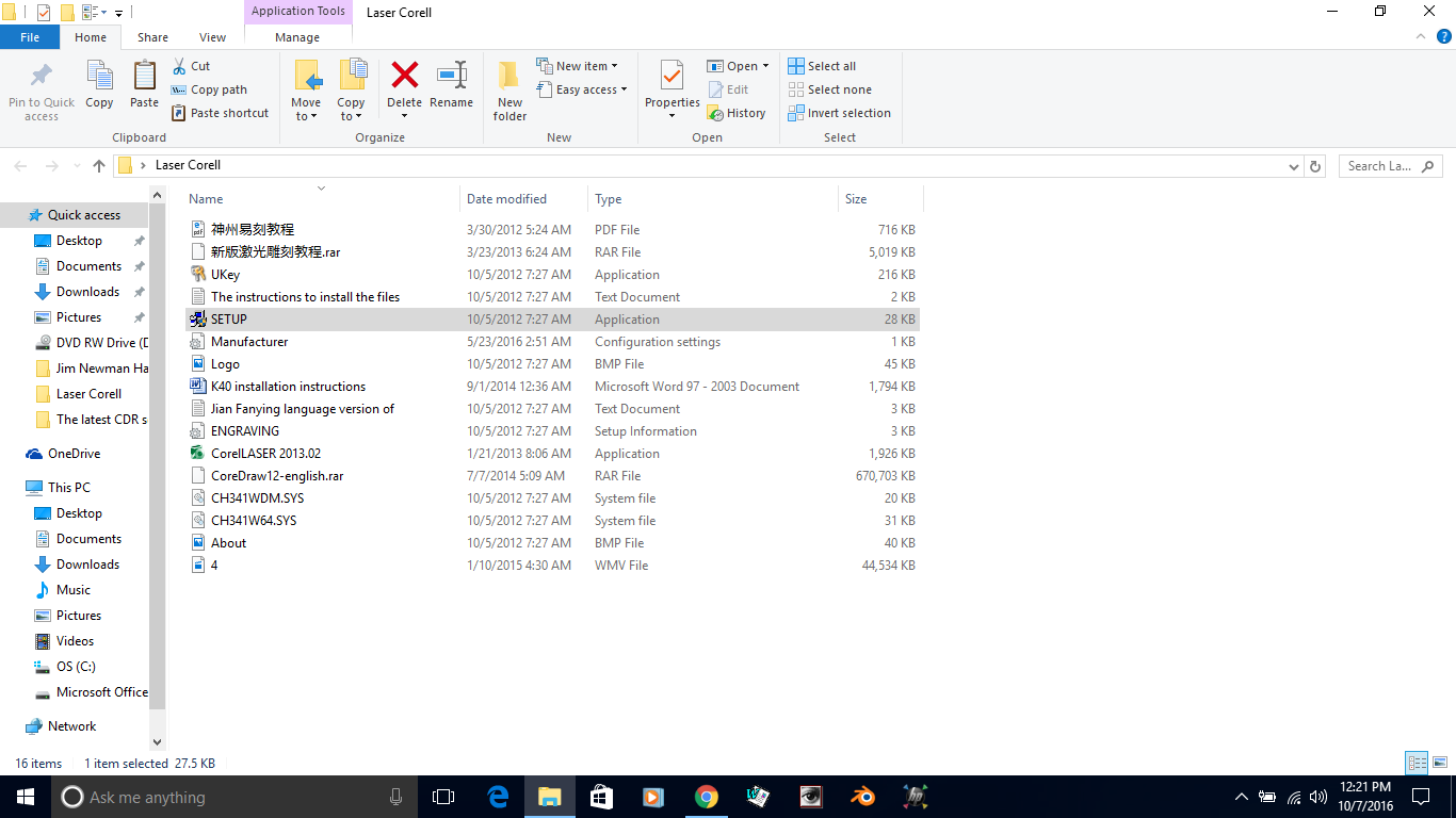

Just got a k40 laser and I’m trying to install the software. When I hit set up it shows me the error I’m attaching as a picture. When I click the bottom Chinese button the instructions come up in English shown. I can install Corel laser shown in the picture of the file directory but when i run it I get a message saying that I need coreldraw vesion 11 or greater installed. I see Corel 12 in rar but I don’t know what to do with it. Can anyone help.
use winrar to extract corel12
then install corel12
then install corel laser
Stevie Thanks that worked great!!! Off I go to get this ready to fire up.
