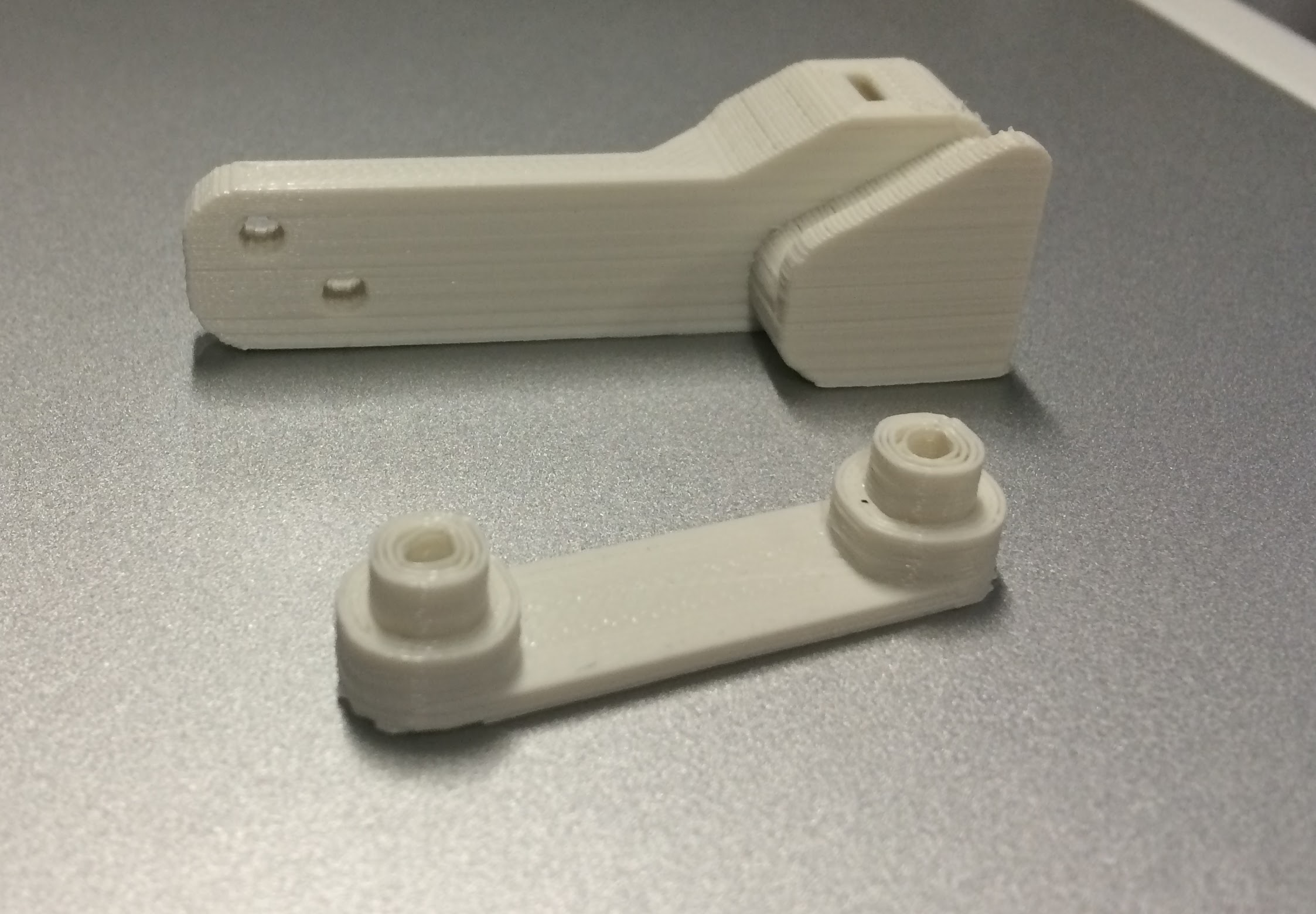

Just got a printrbot simple, so best to have it make upgrades for itself.
Nice prints. What upgrades are these?
What’s the parts purpose?
Y axis belt upgrade
Does that help with backlash? I hope so, because it looks like you’ve got some.
Hi @Jeffery_Myers , how does that help. Could you explain, nice to know. Must say, great prints.

@Tim_Rastall I had trouble with slippage between inner diameter if tubing and the motor shaft. I cut a little 2mm notch in the tubing and it clamped down much better.
I suspect that the tubing resists “collapsing” around the shaft.
Basically if you lick the slippage there, the sanding drums will do fine.

For anyone looking to upgrade their PB Simple, “iamjonlawrence” has some excellent parts on Thingiverse. There’s another that has some nice x/y/z axis extensions as well, but I can’t recall the user name at the moment.
All good suggestions! Saving cost is a trade off. Solving slippage on the motor shafts and absolutely tight string is key.
Mine has ‘iamjonlawrence’ “Double Precision” belt mods on both X and Y currently. I think I’m going to print up some parts for the axis extensions next. There’s even one that extends the Z axis!
Yeah there is some backlash, and I agree that the string can work,but it’s a bit fiddly. I’ve had issues with making it too tight then it slips off the pulley. My plan is to print these parts now then fiddle with the string, then at least I’ll have the belt parts if anything goes wrong.
The simple is a fine printer, my guess is people who get a premade unit will probably not have as many issues with the string on the axes, but I can understand why the new metal simple is using belts.
