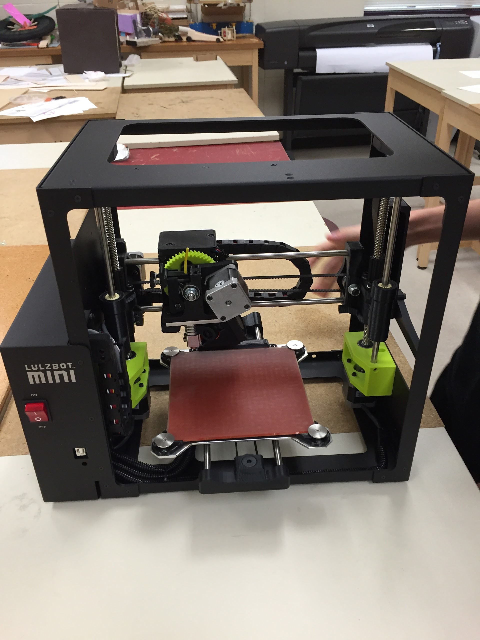

Just got two of these at school. I'm in charge of setting them up.
Just got two of these at school. I’m in charge of setting them up. All of our other printers are 1.75 filament though. Should I switch it to 1.75?
