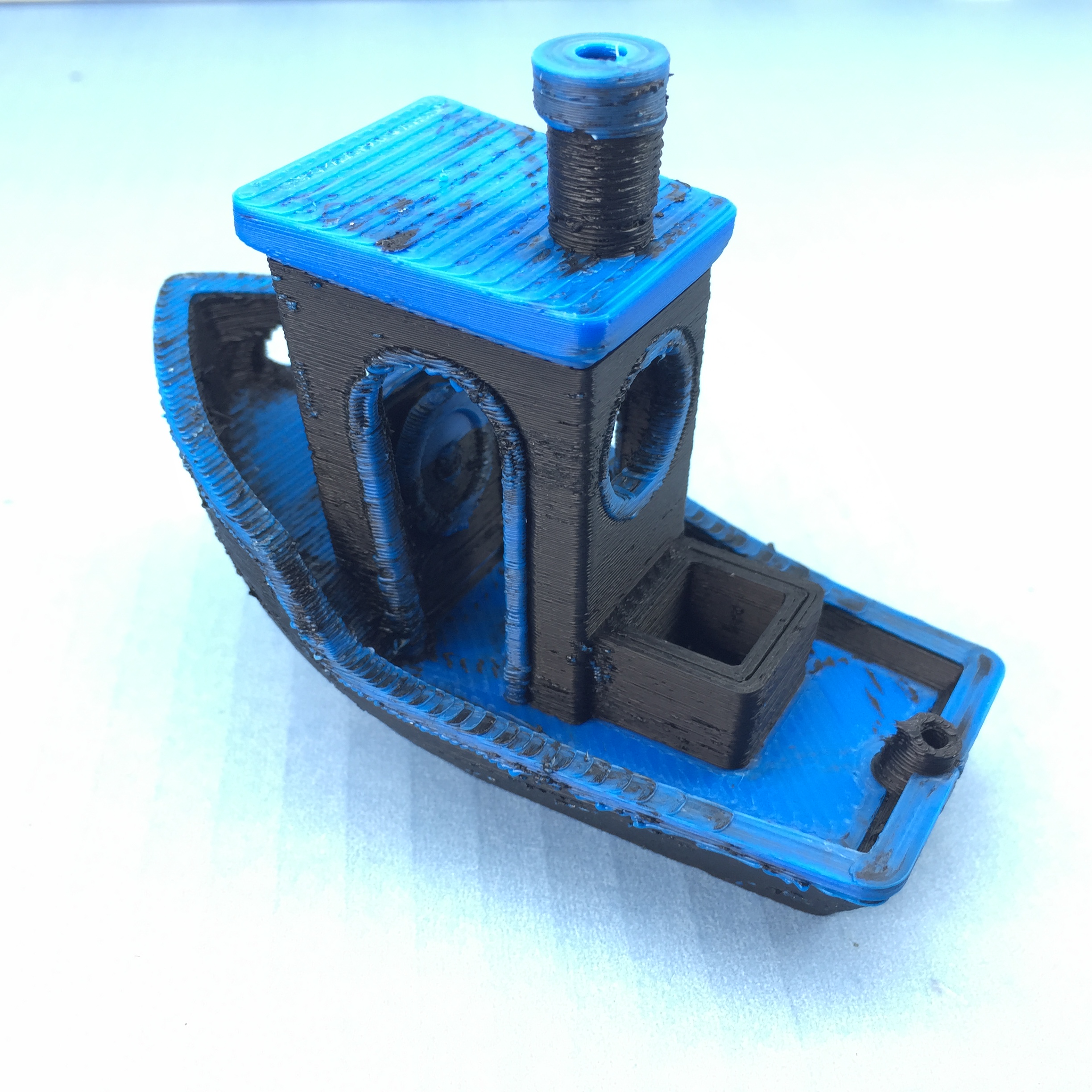

#3DBenchy just got way cooler :slight_smile: @creative_tools has raised the level of torture;) Now it´s possible to go for 17 different colors in one print! Ok I settled for 2 but challenged myself by using blue ABS + electrically conductive & flexible TPU. No webbing :slight_smile: but the carbon black smudges easily :frowning: I need lifting nozzles. This is my first attempt, it is scaled to 1.5 and both nozzles are 0.7mm. Makerbot Replicator dual + Simplify 3D.
Looks good. I’ve been waiting for these, got a large 3 extruder machine to torture test.
Thanks Ray. Cool! looking forward seeing your 3 color version
