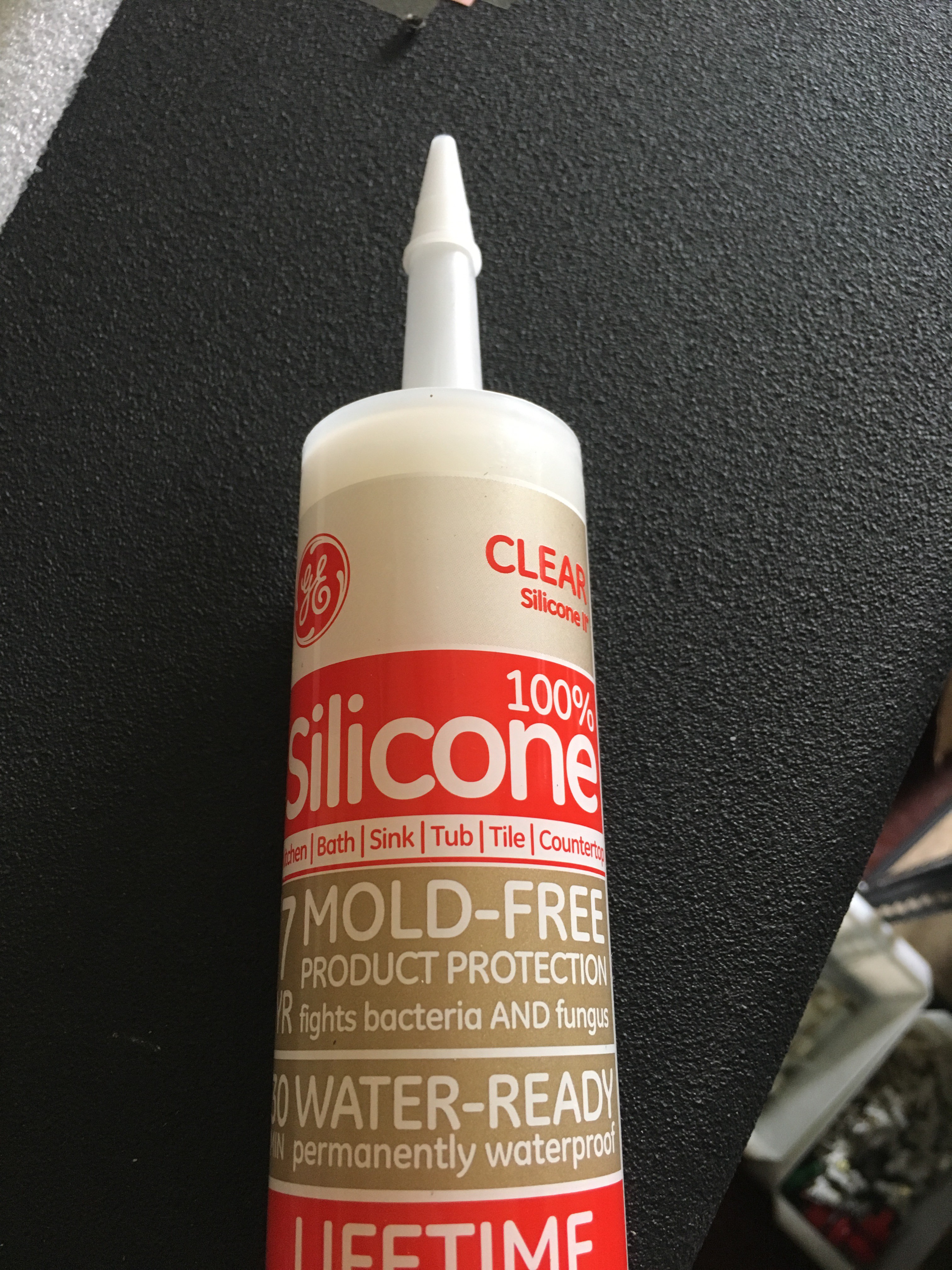

make sure the tube the led strip is in is clean as well, I ran into a problem with silicone not holding because there was some sort of oil on the tube.
Thanx man!
@Richard_Bailey what glue did you use?
GE 100% silicone, any pure silicone should work. It seems that the only thing that will stick to silicone is more silicone…
Im using permatex. Stinks so bad lol. But yeah youre right. Silicon will not stick to anything but itself lol.
Yes, I would definitely recommend cleaning the tube the led strip is in with a cloth and some rubbing alcohol to get rid of any oils. I had an issue with a pair of boots I made for a friend last October because of a dirty tube.
My problem is finding a glue that stick to silicon from the leds ,and rubber from my shoes. Permatex holds for a while then starts peeling from the rubber. I searched far and wide for that miracle glue, never found it.
