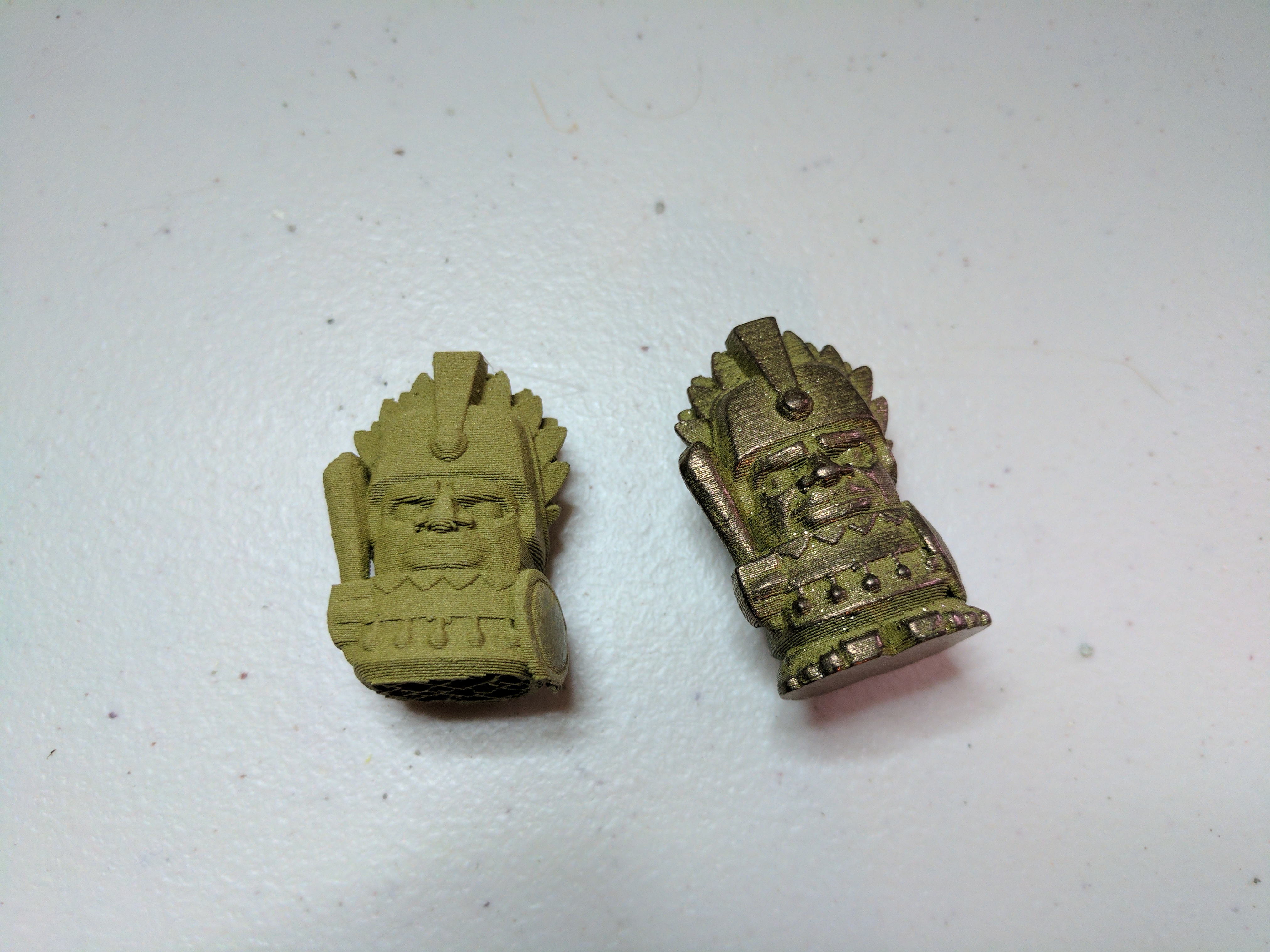

Just had to share this awesome look. Playing w/BrassFill
Yeah, first guy broke off at the legs…definitely not as structurally strong as regular PLA.
Just sanded or is that how it turned out w/o post print cleaning
I dropped it into a custom built rock tumbler with brass ball bearings and cut rods for about 12 hours @Matthew_Del_Rosso ​
@Kyle_Smaagard ah… its a nice finish, been meaning to mess around with metal fills for a while but i need to get my printer working reliably first
Yeah. I’m thinking it will look even better when I use a model that’s more suited to it (less sharp edges and indentations. I have a specific one in mind for a christmas gift that I’m working towards.
