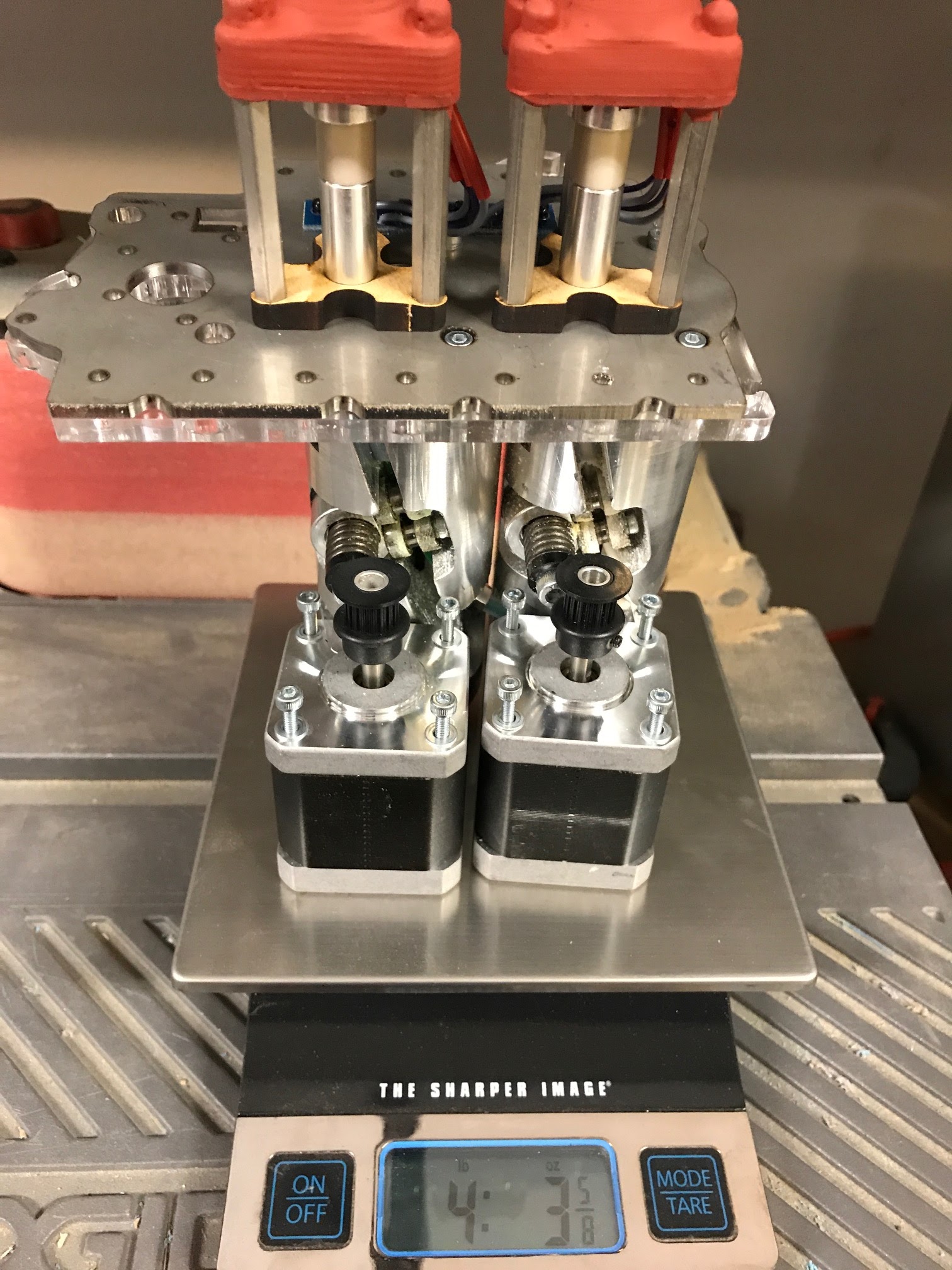

Just had to share this. Started taking one of the 3D touch printers apart.
Took 45 min to remove the extruders & hotends. Just this alone weighs over 4lbs!? That doesn’t include the 20 screws, 5 fans, and CNC’d carriages…can you imagine the 3 extruder setup?
